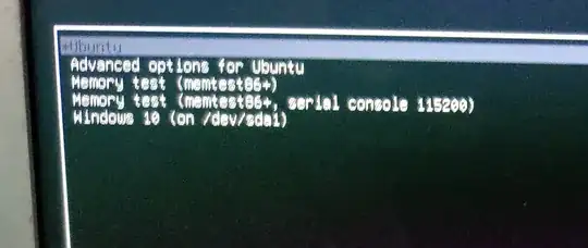

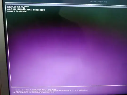

However, now when I power on my laptop, I reach the grub screen as shown in images:
GRUB menu
GRUB menu
Here, I do have an option of Windows 10. But when I move over to it, and click it, the screen color changes to black or something and then again this GRUB menu screen reappears.
So while I can choose to boot into Ubuntu from here (first option), I am not able to boot into my Windows 10.

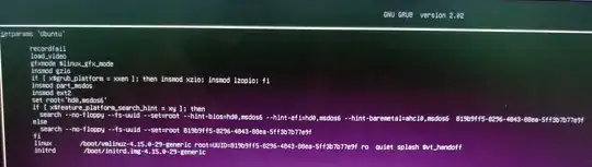

Pressing e on GRUB menu, when Ubuntu is selected, the following options are seen:

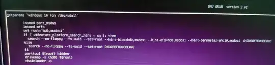

Pressing e on GRUB menu, when Windows 10 is selected, the following options are seen:
