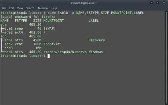

The default installation of windows 10 requires a minimum of 4 partitions:
  1. sda1 (Recovery)
  2. sda2 (Boot/efi)
  3. sda3 (MSR)
  4. sda4 (Windows OS, usually "C")
If the "boot/efi" partition or the "MSR" partition has been damaged or deleted during the ubuntu install you might not be able to see windows in grub. Try the following command in ubuntu to see all the available partition:
sudo lsblk -o NAME,FSTYPE,SIZE,MOUNTPOINT,LABEL
It should give you an idea of what happened to your system. From the screenshot you've provided it seems that all the partition are there. You might try to repair windows with the installation CD/USB.

Here's a screen of what a correct installation looks like: Screenshot:
Hope this helps!
