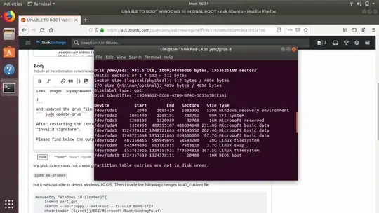

Please find below the output of sudo fdisk -l for reference :

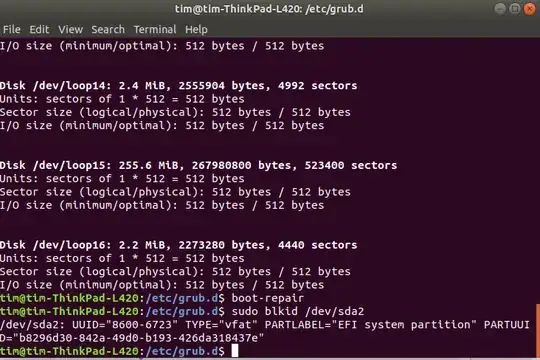

I am also attaching the output of sudo blkid /dev/sda2 for reference :
sda2
