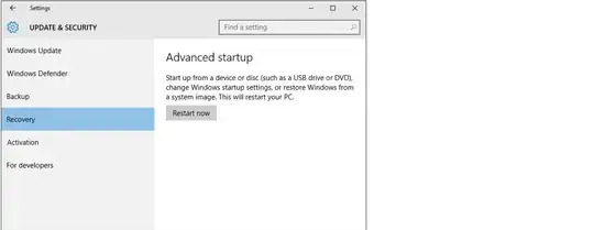

  1. Click the Start menu and select Settings.
  2. Select UPDATE & SECURITY.
  3. Click Recovery.
  4. Under Advanced startup, click the Restart now button. The system will restart and show the Windows 10 boot menu.

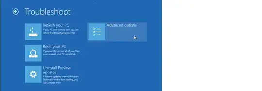

  5. Select Troubleshoot.
  6. Choose Advanced options.
  7. Select UEFI Firmware Settings.

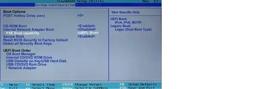

  9. F10 BIOS setup -> System Configuration tab -> Boot Options -> OS Boot Manager -> Ubuntu -> (select the Ubuntu option and move this option up to the top of the list) -> F10 Save and Exit (press F10 to save Ubuntu as the default boot option) -> F10 (press F10 again to save the changes to the BIOS/UEFI setup utility)
When the computer restarts, the Ubuntu boot menu will be shown.
