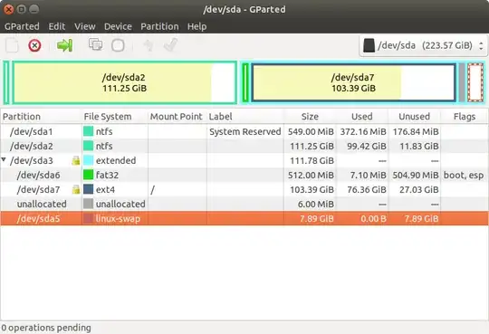

I had a problem with my dual boot laptop. I've had dual booted Windows and Linux for like 1 year, but I wanted to update my Ubuntu or to reinstall it. So I've done that but forgot to check the radio button that says Install Ubuntu alongside with Windows. So that happened... I've lost my boot entry to Windows. Is there any way that I could recover it.
And yes, I've checked the GParted and it says that the partition is there, as well as all files in it.
Edit: I am not sure, but as I can remember there was no UEFI Boot when I was selecting boot location. Is there a way that I can check that? Because it was long ago, I finally found time to fix it, because it was not bothering me. The button I selected said only Install Ubuntu. I forgot to say that the GRUB isn't showing on boot.

I have noticed that my boot was in EFI boot, but the windows was installed on legacy boot. So the answer was to disable EFI boot and do it as a legacy boot option. Then it should boot into the Ubuntu, with the grub loader but with no option about windows. Then, you just have to use boot repair. That's it!
