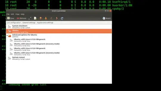

But running sudo update-grub not adding my partition into GRUB menu at startup. I had tried boot-repair. But, it didn't work. I can also see my win partion in gparted marked boot. gparted-screenshot
I had tried this answer from Unable to boot into Windows after installing Ubuntu, how to fix? and rebooted and GRUB menu is unchanged. grub-customizer screenshot: grub-customizer-screenshot Anything I am missing?
