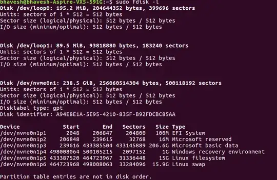

fdisk-l shows
nvm partitions
update-grub shows
generates files only for Linux kernels
os-prober shows no output.
