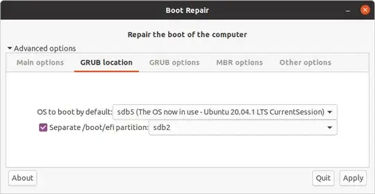

After installing everything correctly, I realized that, after rebooting the OS, GRUB is not showing to me and boots directly on Ubuntu. I run grub-repair, and I am showing a shot from the sw below.
from the picture above, it seems that my OS is installed in UEFI mode. When I run boot repair and I reboot the same problem happens. No Grub showing, it boots directly to Ubuntu.

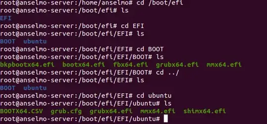

Here are the contents of /boot/efi
screenshot of terminal
