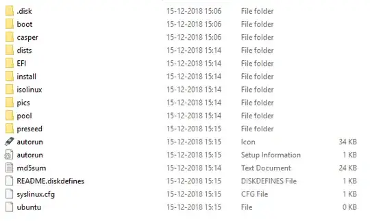

This is a screenshot of my Ubuntu 18.04 live USB folder:

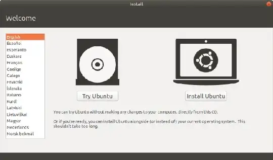

In legacy mode when the laptop boots from the Ubuntu live USB the following screen appears:
Ubuntu installer Welcome screen
There is no option of f6 present there. Also the screen is completely different.

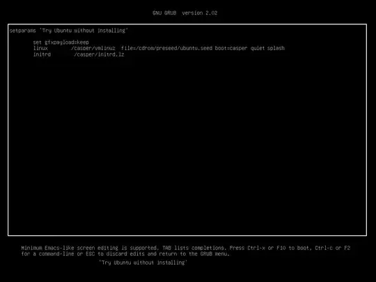

After following instructions from the comments, I entered the grub menu, but my grub menu looks different as shown below.
grub menu
Also there is no ro quite splash. There is only quite splash - -. I replaced it with nomodset quite splash. Then I pressed f10.
The laptop rebooted from the live Ubuntu USB into Try Ubuntu, but still my TouchPad was not working.

Adding the nomodeset parameter to the kernel boot options instructs the kernel to not load video drivers and use BIOS mode instead until X is loaded. This answer has instructions for how to enable the nomodeset kernel boot option.
