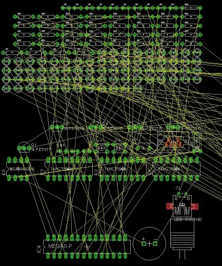

    Don't let this happen to you:
    Yes, this is actually a small snippet of what someone dumped on us here.

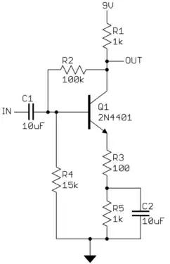

    Power connections should go up to positive voltages and down to negative voltages. Don't do this:
    There wasn't room to show the line going down to ground because other stuff was already there. Move it. You made the mess, you can unmake it. There is always a way.
    Following these rules causes common subcircuits to be drawn similarly most of the time. Once you get more experience looking at schematics, these will pop out at you and you will appreciate this. If stuff is drawn every which way, then these common circuits will look visually different every time and it will take others longer to understand your schematic. What's this mess, for example?
    After some deciphering, you realize "Oh, it's a common emitter amplifier. Why didn't that #%&^$@#$% just draw it like one in the first place!?":

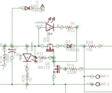

    Here is a small section of a schematic I received. This is from a screenshot displaying a single page of the schematic maximized in Acrobat Reader on a 1920 x 1200 screen.
    In this case, I was being paid in part to look at this schematic so I put up with it, although I probably used more time and therefore charged the customer more money than if the schematic had been easier to work with. If this was from someone looking for free help like on this web the site, I would have thought to myself screw this and gone on to answer someone else's question.
