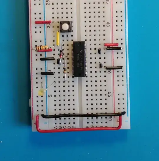

I have been having problems with the resulting circuit sometimes starting in the "unlocked" state, without having to first press the correct sequence of switch. By fault tracing with a voltmeter, it appeared that, sometimes, the different gates are latched in high-output at circuit startup.
Here is a minimal example showing the latching for a single AND gate: enter image description here

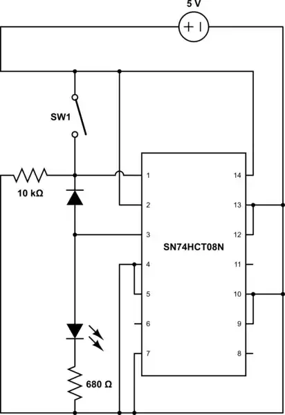

And here is the corresponding schematic (my first, please be indulgent):
schematic
About 1 in 5 times when applying 5V to the power bus, the low-power yellow led will light up, without having to first press the switch.

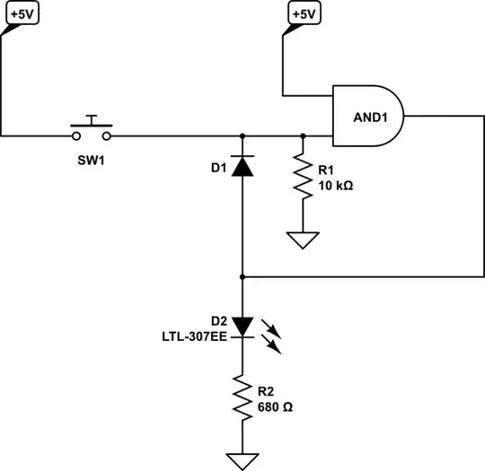

Your circuit is very confusingly drawn but is essentially this:
schematic
This design relies on at least one of the inputs to the AND gate being LOW at power on so that the output will also be LOW. But with all digital logic parts there are "undefined" regions where the behavior is unspecified. At power-up this is where you are.

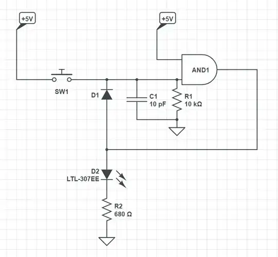

To address this you need to ENSURE that at least one of the inputs is low and one way to do that is by adding a capacitor in parallel with R1. The voltage across a capacitor will be 0V at power on and that will force the output of the AND gate to be a logic 0.
Try something like this. The value of C is not all that critical, try the 10pF and if that doesn't give you the behavior you want, experiment with some other values.

  • @vangelo I was editing and testing my circuit, and it seems to be an efficient solution indeed! Now I have to understand why the capacitor ensures 0V more efficiently than a pull-down resistor directly connecting to the 0V rail. – Ad N Mar 13 '21 at 11:53
    The pulldown doesn't guarantee that the input will be 0 at power-up since the output of the AND gate may be a 1 and will force the input to a 1 through the diode. The capacitor adds delay so that even if the output is 1, it will not have enough time to charge the capacitor so that the input is also a 1. Circuits like this can be very problematic in the real world and should be avoided if possible. – jwh20 Mar 13 '21 at 11:59
