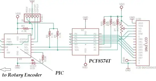

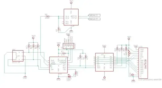

I have 50 and more of the same devices. The main materials found in the device:
  • 1 x Display: 2x16 LCD
  • 1 x I/O expander for I2C Bus: PCF8574T
  • 1 x Regulator: L78M05CDT-TR
  • 1 x PIC: PIC16F1765-I/SL
  • 1 x Rotary encoder
  • 1 x Switch for ON/OFF
The problem is one out of every 10 or 15 is faulty. The LCD doesn't launch correctly.
When I close the switch, 12 volts is applied to the circuit. Most of the devices launch and work perfectly, but a few of them are unable to initialize the LCD but rest of the code works fine (encoder readings, PWM outputs, etc.)
The PIC runs PCF8574T. The PCF8574T runs LCD.
All of these devices were manufactured in machine string. They were programmed with the same code at the same time.
Some determinations:
  1. I think, faulty devices can't start I2C with PCF8574T. When I close the switch, meaningless characters appear on a single line of screen and slide when I change the values via encoder. Second line is always empty. Normally there should be values that are updated occasionally on both lines of the LCD.
  2. The interesting one: When I touch the MCLR pin of the PIC with tweezers the PIC is reset and then the LCD starts fine. When you turn the switch on and off the same problem appears. MCLR pin has external pull ups. On the flawless devices when I touch the MCLR pin the PIC does reset as expected.
  3. On faulty devices only when I change the PIC and replace with a new one and reprogram it the problem goes away. When I change the rest of the components with new ones the problem stays.
  4. On faulty devices when I close the switch while the MCLR pin of the PIC is grounded, the LCD backlight turns on as expected and everything waits. When I set the MCLR high, the same problem occurs, same meaningless slideable chars. When I reset the PIC the same way again but without opening switch this time, problem goes away as I said previously.
  5. Tried to ramp-up the supply voltage several times while switch is closed. Ramp-up from 4V to 12V. Some times while ramp-up the PIC is reset several times then the problem goes away.
Do you think that in such a case do we need to suspect the code or should we look for the solution elsewhere?

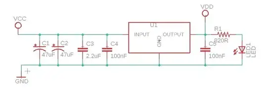

The regulation
These are the decoupling and bypass caps located at nearest location to ICs
These are the decoupling and bypass caps located at nearest location to ICs.

    Where is your MCLR power-up timing capacitor? – Transistor Feb 20 '20 at 20:03
  • If reprogramming doesn't work and you actually have to replace the PIC, would that not count as a hardware issue? Unless you are asking if it's a hardware variability that could be, but isn't, accounted for in the code. – DKNguyen Feb 20 '20 at 20:03
    It is possible that the PIC powers-up before the LCD or possibly before the PCF8574. Code may send LCD initialization sequence too early. The solution is to add a do-nothing delay from a reset or power-up. – glen_geek Feb 20 '20 at 20:04
  • No MCLR power-up timing capacitor was a mistake, I will pay attention after that, i tried to add the cap but didnt affect the problem. – Lenel Feb 20 '20 at 20:33
    Maybe LCD init code has timing or logic issue and it does not work properly? Maybe I2C code is not fail-safe and some glitch prevents I2C comms? Post the code so we can see. Hardware issues are possible too; there is not a single bypass capacitor drawn on the schematics, and the regulator is not seen in the schematics so it is difficult to pinpoint a problem. – Justme Feb 20 '20 at 20:34
  • @Justme noooooo the lack of bypass caps! on 50 boards! – DKNguyen Feb 20 '20 at 20:41
  • I tried to put a __delay_ms(500) [XC8] before and after SYSTEM_Initialize but didnt affect the problem.Is it possible that the timing is suitable for most devices but not for a few of them? – Lenel Feb 20 '20 at 20:44
  • Bypass capacitors used only did not fit for screenshot – Lenel Feb 20 '20 at 20:45
  • I will share code and shematics when i able to do. – Lenel Feb 20 '20 at 20:53
    What I2C speed you use? Are you aware that at powerup the IO expander sets all pins high with internal pull-ups so without proper handling of the IO expander the LCD might see falling E edge so it sees random command/data? When resetting the MCU, the expander keeps state between MCU resets, and resetting the MCU during middle of I2C transaction can leave the bus in a state where the IO expander is sending out ack bit or zero bit so SDA is low and MCU can't send start without special recovery sequence. Note that this IO expander does not have a reset pin so there is no easy way out of this. – Justme Feb 20 '20 at 20:58
    Also beware that LCDs have two operating modes, 4bit and 8 bit. If you do not use the right start sequence they will stay in the same mode. If it comes up in 8 bit mode it will not work. – Oldfart Feb 20 '20 at 21:04
    @Oldfart true, that's why it is important there is no glitches from the expander init, or if there is, the sequence must be designed so that it works in every case (I2C bus issue, expander init issue, LCD init issue). Proper sequence is to set the LCD forcibly back into 8-bit mode at start no matter at what state it is, and then return back to 4-bit mode and continue with the init. – Justme Feb 20 '20 at 21:13
  • I will start researching on the subject you have pointed out. But does this explain how it works properly when I replace and reprogram the PIC? – Lenel Feb 20 '20 at 22:13
    Power-up issues, clock issues, start-up timer issues? Slow supply voltage ramp-up time, so the chip goes out of reset and starts to run even though voltage is too low to run at that frequency? Different PICs have variance/tolerance at how high speeds it can run vs supply voltage? What is the measured supply voltage? Does the LCD backlight clamp the supply voltage as there is no external current limiting resistor on the backlight? – Justme Feb 20 '20 at 23:00
    Oh no, those schematics are abysmal! Thankfully, here is a community wiki to help you with that! By the way, did you know you can use net labels in Eagle to only connect some things by name, not all by actually running a line between them? It can significantly improve readability too, when used correctly. – Richard the Spacecat Feb 21 '20 at 11:52
  • Yep you are right and sorry for that. I ll follow your advides.. – Lenel Feb 21 '20 at 11:57
    I2C_ISR is pretty much a school book example of how to never write an ISR. Apart from it being massive, it uses numerous variables that don't seem to be protected from race conditions: i2c_state, p_i2c_current etc. And you even write to these from the caller? If they aren't protected, the software will behave randomly. It doesn't look like you can salvage anything from that ISR, I would rewrite this from scratch. – Lundin Feb 21 '20 at 12:15
  • Make sure you have BOR enabled and the voltage configured to an appropriate voltage. – Spehro Pefhany Feb 21 '20 at 12:18
