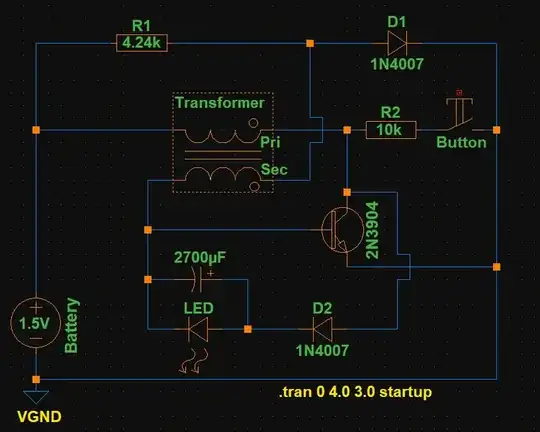

schem Download schematic: https://drive.google.com/drive/folders/1Vr9mQx449-RmjqclVZdgrnk5SyXjxTlG?usp=sharing
(I tried to simulate the circuit in LTspice. Thanks for making me aware of this amazing program, Sredni Vashtar!)
What the pushbutton is used for:
The pushbutton is used to "kickstart" the oscillation when it wont start by itself.
For example: I have to manually "oscillate" using this button to start the circuit if the capacitor is too big and battery voltage is low.
Pushing the button releases the energy in the transformer into the capacitor. If it reaches LED forward voltage the circuit keeps oscillating on it's own.
It does work without manual intervention when then capacitor in parallel with the LED is not too big, like <5000 µF, and it's a fresh battery.

  • In your circuit the LED is in series with 2 diodes of opposite polarity to it. How can it work? https://electronics.stackexchange.com/questions/28251/rules-and-guidelines-for-drawing-good-schematics – Bruce Abbott Mar 26 '18 at 10:55
  • Don't link that. It is drawn correctly. But you're right, why does it work? I just realized this too.
    I double checked everything. It is correct. Without the SB5009 (The diodes) the circuit does not work. Without the capacitor/s it works fine, but the LED flickers. They're just smoothing.
    – Distelzombie Mar 26 '18 at 14:17
  • Oh. A third check shows the LED and capacitor are the wrong way around. FFS! The diodes don't have opposite polarity though. They're in parallel. Look again. :)
    Also: I did not draw the circuit diagram for this question. So the linked "rules" don't really apply.
    – Distelzombie Mar 26 '18 at 14:23
  • There. I fixed it. Now it is definitely correct. Quadruple checked! xD – Distelzombie Mar 26 '18 at 18:33

  • Done. To further clarify the schematic I had to make my own transformer that allows for all variables to be changed. --- I'll open a new question for the efficiency thing later. And then another one for how to model a simple wire as a symbol, without any resistance. – Distelzombie Apr 03 '18 at 20:01

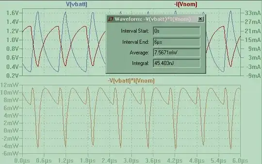

Computing power
So both the voltage across and the current supplied by the battery can vary, and depending on the powered circuit they do it with a time dependance that can be very complex, not necessarily symmetrical, nor periodic. Why is that important? Because to compute the instantaneous power p(t) = v(t) i(t) absorbed by your circuit you need to get both i(t) and v(t) right.

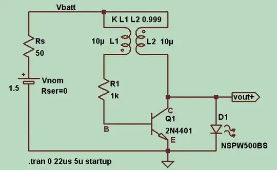

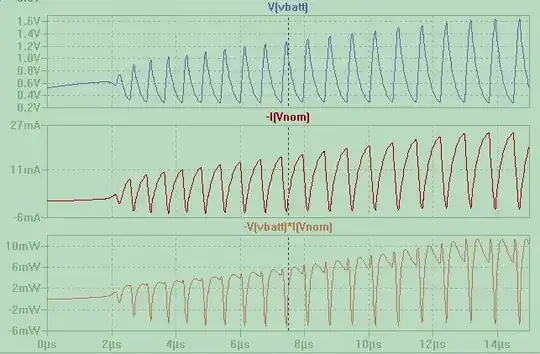

To illustrate all this, let's consider this simulation of a Joule Thief circuit powered by such non-ideal battery:
As you can see, a pulsed current drawn from the circuit results in a pulsed voltage variation at the battery terminals:
The voltage swing at the battery here is grossly exaggerated by the unusual high internal resistance chosen. Two notes on the signs: first, I had to put a minus sign before I(Vnom) because LTSpice adopts the user convention for the current in the battery - since I want to call i(t) the current exiting the positive pole of the generator, I have to use i(t) = -I(Vnom). The product v(t) i(t) = -V(Vbatt)*I(Vnom) gives you the instantaneous power delivered by the battery and drawn by the attached circuit. Second, the circuit is higly reactive and the swings in current are so wide that they can also lead to a sign inversion. This means that at certain times the current is entering the battery from the positive pole, resulting in a negative power, i.e. power wasted by the battery instead that used up by the load. This is an extreme effect of the humungous values for Rs, associated with the back-kick coming from the coils.
At any rate, once we have v(t) and i(t) at every t, we know all we need to know about power. Moreover, since in this case the waveforms tend to a periodic steady state (or so it seems on the selected timescale), we can even compute a meaningful average power by integrating over an integer number of periods and by dividing by the time interval.
LTSpice can do that for you: hold down the CTRL key and left click on a power trace name. A small window will pop up showing the average power and the average energy over the selected time interval:
This Joule Thief appears to require some 7.5 mW to run, when the power delivered to the LED only is 4.5 mW.

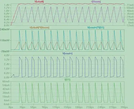

A more realistic example
As already mentioned, the battery internal resistance has been grossly exaggerated in order to highlight the variability of battery voltage. If we reduce its value to a more believable 0.8 ohm (still some 4 times the average series resistance of an AA cell) the effect on the overall battery voltage is greatly diminished. The circuit will behave so differently that other modifications are needed in order to avoid burning the LED. By changing base resistance and using a different transformer with much higher inductance and a 2:1 ratio, we get this circuit
that appears to oscillate at a frequency of 56 kHz with a peak current in the LED of nearly 60 mA (average current is only 10 mA). Note how small is the voltage swing at the battery terminals, now.
By selecting a time interval where the waveform are periodic, and by using the CTRL + right click trick, we find that in this case the average power drawn from the battery is 47.3 mW, while that used up by the LED is 42.5 mW. This amount to nearly 90% efficiency.

  • Wow, thanks for your answer! The transformer I use is a commercial Choke or Isolating transformer. One to One ratio winding. With the marking "240" which is it's inductance. I think simluating this one wouldn't be very hard, would it?(Inductance is roughly measurable with my "Multi-function-tester T6". One of those component testers from china. Quite inaccurate). ---I'll download LTspice and play around with it. --- Unfortunately even the old analog Oscilloscopes are about 100€ today. So I don't have money for that. I wish though. – Distelzombie Mar 31 '18 at 16:43
  • Very awesome program! I played around with it. I remade my circuit as accurate as possible. Take a look at my question for more questions and files! Thanks dude! – Distelzombie Apr 01 '18 at 08:39

    In your new circuit you label a node "VLED", but that's not the voltage across the LED, it's the voltage of that node with respect to ground (click and drag to measure differential voltage). And as for the efficiency, well, 22.65% efficiency looks like a legit value. But before computing that, you should isolate a time interval where the waveform are periodic. The Joule Thief I simulated takes an average of 7mW from the battery and gives an average of 4.5 mW to the LED. – Sredni Vashtar Apr 02 '18 at 23:59
  • So... do I have to subtract the voltage behind the LED from the voltage before it? If I alt-click on the LED, it does something like that. I learned that yesterday evening: V(VLED,N004)*I(LED) But that gives no different results – Distelzombie Apr 04 '18 at 20:18
    Didn't you make the same "mistake" in your pictures? It's also vled*i – Distelzombie Apr 04 '18 at 20:27
    my LED has the cathode at GND. Yours doesn't. Click and drag the probe: you will see the red probe icon fixed and a new black probe icon that you will place wherever you want your measured voltage referred to. See https://www.electronicspoint.com/resources/displaying-and-measuring-signals-i.10/ (last part of fig. 3) – Sredni Vashtar Apr 04 '18 at 20:31
    Oh. Ok, so it is exactly like alt+clicking on the LED. I thought it didn't change anything, but it does. Thanks again :) – Distelzombie Apr 04 '18 at 20:42
