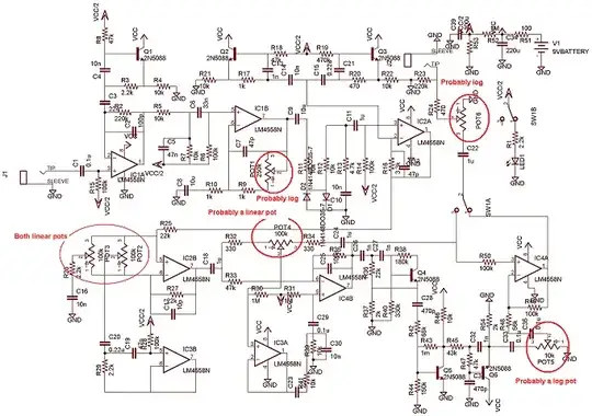

Here is the circuit diagram

  • @AndrejaKo thank you I have updated the question with the circuit diagram! – Metalhead1247 Jul 12 '13 at 10:53

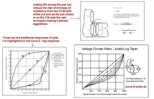

Well you can modify the linear pot to get an almost logarithmic response by adding a resistor from the CCW side to the wiper. Because of its simplicity this might be worth a try. Here's what the idea looks like: -
For the pedal circuit you need this might be ideal. It's not perfect of course but it reduces the risk of buying linear pots because these can be made "almost logarithmic by adding one resistor.
One thing to remember is that if the design calls for a 1M pot and you have a 1M resistor across wiper to CCW, the end to end pot value will change as the wiper advance towards CW. This would probably mean that you should use a 2M pot and 2M resistor.
Some experimentation is required and if you could post a circuit I'm sure better advise could be given. Pictures gleened from here
EDIT - picture of circuit attached with my best guess at log/lin: -

  • i have posted the circuit diagram! ty! – Metalhead1247 Jul 12 '13 at 10:54
  • Could you add a link for those images? – m.Alin Jul 12 '13 at 11:20
  • http://www.mediafire.com/view/k1ag0nq64qdp9cu/mypedalcircuit.png – Metalhead1247 Jul 12 '13 at 11:25
    @m.Alin link added as requested – Andy aka Jul 12 '13 at 16:17
  • @Andyaka i got the potentiometer codes but not the type.can you tell me which code represents linear/log/other type of pot? POT1 dist 250K A
    POT2 low 100K W
    POT3 high 100K W
    POT4 mid 100K W
    POT5 top 10K B
    POT6 volume 50k A
    – Metalhead1247 Jul 14 '13 at 05:31
  • @Metalhead1247 I dunno - the ones I marked on the circuit is all I know - I don't know about the codes - what are they dude? BTW I'll expect to hear the sound your getting from yer axe when it's done - I'm a musician too and if ya check out my website you'll hear a bit of stuff I've written!!! – Andy aka Jul 14 '13 at 12:07
  • @Andyaka Even i'm a musician :) This pedal is the MEtal muff with top boost :P, The codes specify the type of potentiometer,I found out that a B is linear and A is log. W is unknown, even google doesnt know about w :P. But a W pot has a s curve – Metalhead1247 Jul 14 '13 at 13:08
