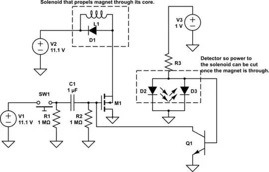

I have a 11.1V LiPo battery that can supply 100A. It's being used for a coil gun like in this image from electroboom. (The difference being he uses a power supply with built-in current limiting, connected to the wall, whereas I'm using a battery).
schematic
There is extremely low resistance, as its mostly just going through a wire. It would seem that the magnet must induce a reverse voltage, or somehow use power, but I have no clue how much. So, it surely can't just use a very low voltage at all times. All the guides I have found are for only around 1A constant current sources. How would I make one for 100A?

  • I'm a little confused about why you say you want a constant current source for 100 A. Isn't that an inductor there? Constant current sources and inductors don't fly together often. (An inductor tends to resist sudden changes in current fairly effectively.) What's your thinking about this? – jonk Oct 20 '16 at 21:59
  • Sorry about the schematic, fixed. I don't know much about this, but I'll try to keep the inductance low, and it will be given enough time to allow current through before the magnet being propelled gets near. I don't know about once the magnet is inside, but at that point the main concern is to not draw any more than 100A. – TheSandwichMakr Oct 20 '16 at 22:08

  • YOur photo interrupter is still shown wrong with shorted emitter detector missing transistor etc. although a PhotoDiode would be faster. – Tony Stewart EE75 Oct 21 '16 at 00:45

Here I have shown a Photo diode interrupter (PD) instead of a photo-transistor and inverter so the output so that uninterrupted current turns of Vbe. Note the PD is alway reverse biased as it "sources" current, while the emitter LED is forward biased and the resister across Vbe sinks current quickly to turn it off at the point where the magnet projectile is forced and then cut off by the PD cutoff or the Switch cap decay time-constant, whichever comes first. So Gate voltage clamp or decay below Vgs threshold switches the coil current from the MOSFET to the diode and the Coil current ramps up then down just as the magnet slug begins to leave the coil field and not after. Polarity must be pre-determined so it does not exit on the wrong side of the coil.
The switch gate sees the Vgs gate resistance and discharges quickly in about 150us due the gate current limit defined in this project. Then the diode current is the same and it's ESR must be as low as the MOSFET RdsOn, which can be determined from any diode datasheet VI curve.
The MOSFET specified is good for 0.7 0mΩ @ 10V, which means all the loop resistance is in the coil and much heavier Litz or braided wire must be used for best performance in the large current loop. I re-arranged your schematic to show that the large "logical" current loop must be "physically" small using twisted pairs to the coil and also to the PD sensor in order not to have any induction current cross-talk. Layout is critical. The grey dotted lines show twisted shielded pairs that MUST be immune to 100A spikes, so the high current and PD current must be widely separated and at right angles to each other.
