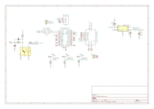

Circuit http://ozmach.com/public/board-v2.zip 1: http://ozmach.com/img/schematic.pngenter image description here

  • I dont use circuitlab but i added as a png – calynr Apr 02 '18 at 08:19
    U4 is a relay with no flyback diode? – winny Apr 02 '18 at 08:29
  • Please answer few more questions: Where have you connected push button to: to which Pin, What are the R and C values? how are they connected to the switch? When you say voltage spike, did you have chance to measure it? voltage spike on which line? – User323693 Apr 02 '18 at 08:30
    When you get this problem sorted out it would be worth your while studying Rules and guidelines for drawing good schematics. You have pull-up resistors draw pulling downwards to a +5, the switch circuits all reading right to left and hardly any wires between devices so circuits can't be traced. – Transistor Apr 02 '18 at 08:36
  • resistor values are 10k, capacitor is 1uF, pin is PD2. I dont have oscillator so i cant measure. I dont know which line has voltage spike but in stated examples, my chip reads rarely button is pressed. – calynr Apr 02 '18 at 08:38

    Do you mean oscilloscope? Show layout, because it sounds like interference. – winny Apr 02 '18 at 09:04
  • I'm directly sharing the project files in zip format. You can open it in kicad. – calynr Apr 04 '18 at 08:20

Your idea with the relays is good, but it is just a workaround for the real problem. Your DC/DC converter is a major source for noise if the layout is not done carefully and I guess it might be the reason for the spikes. Try to use a simple linear regulator or other (clean) DC source. If that helps, then you can concentrate on improving your DC/DC converter.

  • I agree, relay seems to me as an ad-hoc solution too. I used 7805 firstly, but i realized that it is getting heated, not too much, even so i changed with lm2575 – calynr Apr 03 '18 at 09:18
  • @ArnesTwin To rule out problems caused by switching power supply, replace it again with a 7805 or other linear regulator and test it again. Does it react to spikes even when powered trough a linear regulator? If your problem is the heat, try using an LDO regulator and a bigger heatsink. – LorenzoDonati4Ukraine-OnStrike Apr 04 '18 at 08:22
  • I shared project files, you can look at the manufactured board which is mentioned in the question. Heat was about 50-60 celcius and power supply is 220 to 12V 8.5A – calynr Apr 04 '18 at 08:26
  • BTW, you say you are using an LM2575: did you design the power supply circuit around that chip yourself or did you use an already-made module? As Stefan said, building an SMPS around a switcher chip (even a tolerant one like the 2575) is much more difficult than putting together a PS around a 7805 or an LM317 chip. A wrong layout could literally kill your project (the chip could oscillate wildly). One of the most common mistake is not to create proper star grounding. Usually the datasheet mention this, but many newbies (if you are one) skim on that. – LorenzoDonati4Ukraine-OnStrike Apr 04 '18 at 08:26
  • i used already made module, it is something like this link . LM2575 will exist in new design. 7805 is used in the board which i mentioned. In new design, i created ground zones on bottom and front layers. I am just trying to understand why that happened or happens. – calynr Apr 04 '18 at 08:54
