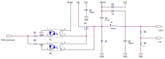

Arduino- controlled buck regulator power stage
Ok, so this is the scheme i propose.
Disclaimer: in real life you will never do anything like that. This is only good for detailed buck controller study. This is not cost effective, not universal, not very power efficient and not simple at all. If you want a real design, you need to refer to buck controller IC of any descent vendor and read the datasheets accurately.
Disclaimer 2: i am not sure for how long and how deep i will be able to explain the theory. You must study that by yourself, it's not that hard.
So in the scheme i propose, you have a switch MOSFET, inductor and output capacitor that will do a good job for 20kHz PWM (i don't think Arduino can do much better), D1 will allow L1 to keep conducting when the switch is off.
R3 and R4 will provide feedback. Configure them so when the output is stable, the voltage is in the middle of your ADC range, probably it will be 1.65V
Now what made you most of your problems. To drive M1 you need voltage higher than Vs. So there is C2 that will be precharged to VCC at the beginning, and once your output is stable, with VOUT. When M1 will be switched on and the voltage on switching node will rise to VIN, C2 will still be charged, and provide VIN + VOUT voltage, allowing to keep M1 open.
U1 and U2 are used to quickly charge and discharge M1 gate. Pay attention, i use AC optocouplers. For DC optocouplers you may need a bit different input. Under no condition open both of them!!! it will just blow them. Consider logic gate to prevent such event.
Components selection: Define what voltage and current you need on output.
Select the L1 to have 200% of IOUT
C1- 200% of VOUT.
D1- 200% of IOUT and 150% of VIN for reverse bias, low leakage, minimum forward voltage.
C2- 200% of VOUT
C3- 150% of VIN
M1- VDS > 150% of VIN, Idrain > 150% of IOUT, VGS < 80% VOUT, VTH < 80% of VCC
Testing: Start with VIN = 12V and PWM of 20kHz, 50% duty cycle. Put 100R power resistor as load. You will have to measure about 6V, if everything is allright.
