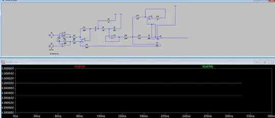

It supposed to be a sine but here is what I get. What should I do?
This is with LTspice:

    For R8, If you are trying to use 1 Megaohm then type "1Meg" instead of "1M" because LTspice will take it as 1 milliohm and convert it to "1m". Using 1 milliohm is no different than shorting R9-C1 junction to ground. That might be why your circuit is not working as expected. – Rohat Kılıç Nov 21 '22 at 15:46
  • Your schematics are a mess, clean them up and your errors will be easier to find. – Renan Nov 21 '22 at 16:33
    It helps to follow conventions for drawing schematics. They make it easier for others to understand, but they also help you to see if you've really drawn the circuit you had in mind. – JRE Nov 21 '22 at 16:51

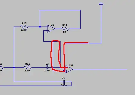

Take a close look at U6. You have both inputs connected to ground. The output of U6 will be zero volts, no matter what the rest of the circuit is doing:
Another problem you have is that R8 is given as 1 milliohm:
That low value resistor short circuits your signal to ground.

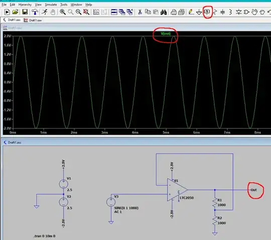

It helps to use labels so that you and other folks can tell what trace is what in the plot:
Use the "Label" function to add labels. When you click on one in the schematic while running the simulation, the trace that appears in the plot will have the label name on it.

One obvious problem is that both inputs for U6 are tied to GND.
