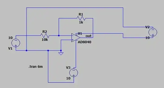

i want to invert a negative voltage (-10V) to positive voltage (1V), my problem is :
  • i dont get the 1v DC at the output.
  • i get an ac signal at my oscilliscope.
and i dont know why ? this is my schematic LM741

  • Just a brainstorming suggestion. I read the following tutorial to refresh my memory: https://www.electronics-tutorials.ws/opamp/opamp_1.html. Then I compared the tutorial's basic circuit and yours. It appears that you are somehow feedbacking output to input, thereby causing an oscillation. I would suggest (1) Do not feedback output to input, (2) Use a resistor divider to get -1V signal to input to op-amp's "-" and "+" input terminals. – tlfong01 Aug 04 '20 at 08:20
  • I read another forum discussion for op-amp voltage divider: https://electronics.stackexchange.com/questions/170764/the-purpose-of-voltage-dividers-in-op-amp-feedback. I found that my above suggestion is rubbish. @MarkU's explanation is good. So please ignore it. My apologies. – tlfong01 Aug 04 '20 at 08:25
One of the limitations of the 741 op amp is that it is not a rail-to-rail op amp. There must be some headroom of at least 3V between the power supply rails and the output voltage. You need to increase the power supply rails to +/- 15V as per the datasheet.
Note: the feedback as shown is configured for closed-loop gain of -0.1V/V; that is attenuating the input signal instead of amplifying it. I think I must have misread the question initially, since it's very unusual to use an op amp for attenuation instead of gain. (Thanks @Indraneel)
A third problem is that there is no input bypass capacitors shown. Without power supply bypassing capacitors, the inductance of the power supply leads will cause the op amp to oscillate.
