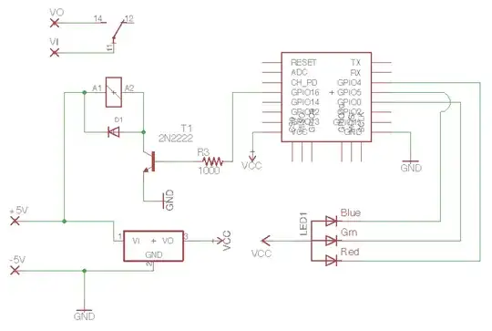

I am trying to make a WiFi controlled relay. I believe that my circuit works fine, but I would like others to look over it before I get it fabricated. The voltage powering the entire system is coming from a 5v AC to DC converter. Here is what the circuit looks like:
Here is my parts list since some of them are unlabeled:
  • Relay: Songle SRD-05V
  • Diode: 1N4148
  • Transistor: 2n2222
  • LED: Microtivity IL612 (Common Anode)
  • WiFi: ESP-12E

  • Leaving floating inputs is unwise and no Vcc decoupling shown. Relay contact current or voltage transients for EMI is unknown. No POR? – Tony Stewart EE75 Dec 01 '17 at 05:23
  • At the upper left there's a switch for $VO$ and $VI$, the same labels are used at the bottom left (in the box), which looks like an LDO. Is that a switch for bypassing the LDO? – Harry Svensson Dec 01 '17 at 05:32
  • No current limiting on led and voltage is not high enough for good control of current. R3 too high value. What Tony said, also the esp needs some resistors pull-up/down and the regulator (whatever it is) should have largish caps in the input and output, according to the data sheet. I realize you may not have the rep to include a bunch of links but if possible it is always good to include links to the manufacturers' datasheets for all relevant components. – Spehro Pefhany Dec 01 '17 at 05:35
  • @HarrySvensson That is the default labels for the voltage regulator, they do not have any connection to the AC VO/VI pads. – Jeebus Dec 01 '17 at 05:35
  • @HarrySvensson that's the relay contacts, the vr designators are not net labels so there is no conflict. – Spehro Pefhany Dec 01 '17 at 05:37
  • Sorry I am not familiar with some terminology- what do you mean by POR and EMI? @TonyStewart.EEsince'75 – Jeebus Dec 01 '17 at 05:41

  • EMI=electromagnetic interference. POR = power-on reset. EMI is shorthand for the various compliance tests a product might have to go through to insure it does not cause interference with radio equipment. Power-on reset is almost a thing of the past because most microcontrollers now incorporate it internally. But in the bad old days, you might use an external reset chip to hold the processor reset asserted until the power voltage was above some certain threshold for some certain time. – user57037 Dec 01 '17 at 07:32
  • Except that of mentioned decoupling capacitor, too big R3 and missing limit resistors for RGB diode (is ESP-12E able to provide enough current to lit your LEDs?) you would miss 'Reset' and 'Boot' switches - they can be helpful when you decide to do firmware update later. – smajli Dec 01 '17 at 08:19

  • You have to read the datasheets of the components carefully and you should follow their proposed schematics, because in your schematics there are errors and missing components (decoupling capacitors, resistors). – Ange Mechanic Dec 01 '17 at 11:21
You ask about the circuit, but your schematic is too much of a mess to get into that.
Engineering requires attention to detail. For good results, this must be carried out thru the whole design process. A messy schematic is either the product of messy thought, or a Eh, it doesn't matter attitude. Either results in a bad design.
Problems with the schematic include:
  1. No component designators on some parts. This looks like it was done in Eagle. Eagle makes it very easy to show component designators per part. There is no excuse for this.
  2. The labels for the pins sticking out the bottom of the large block collide with the labels of the pins sticking out the side. Surely you could see this for yourself.
  3. The GND symbol below T1 is sideways. You clearly had room to make it right side up. In fact, that would have been simpler. This makes it more effort to look at your schematic, and is just rude.
  4. The flow around T1 is right to left, although it's not a feedback path. It is nice to keep logical flow left to right when possible, and it certainly could have been here with a little re-arranging of parts.
There are some glaring problems with the circuit too, but once you take some care with the schematic, you may find them yourself.
