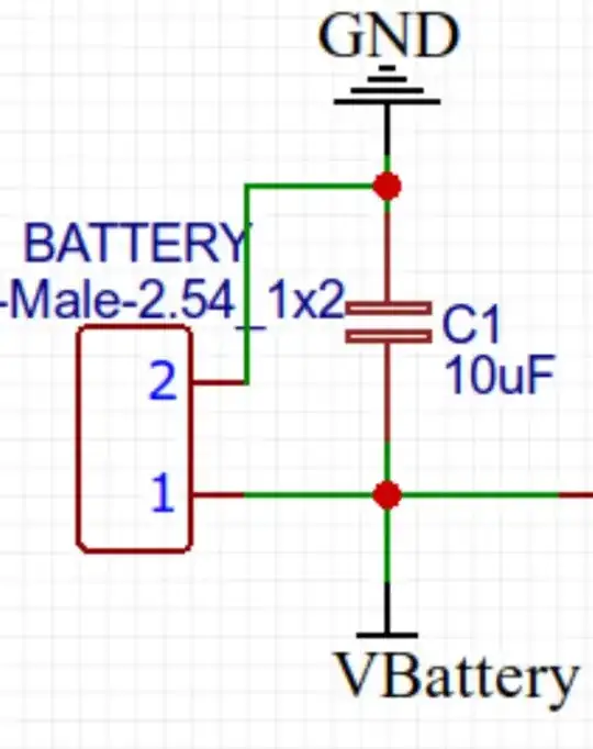

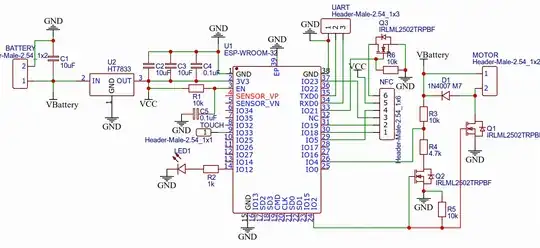

Old Schematic: Schematic

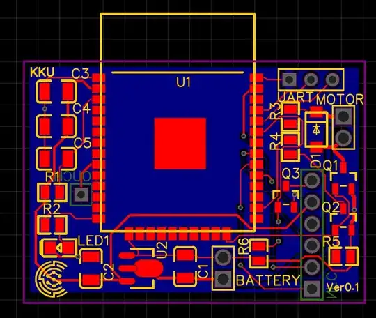

Old PCB: enter image description here

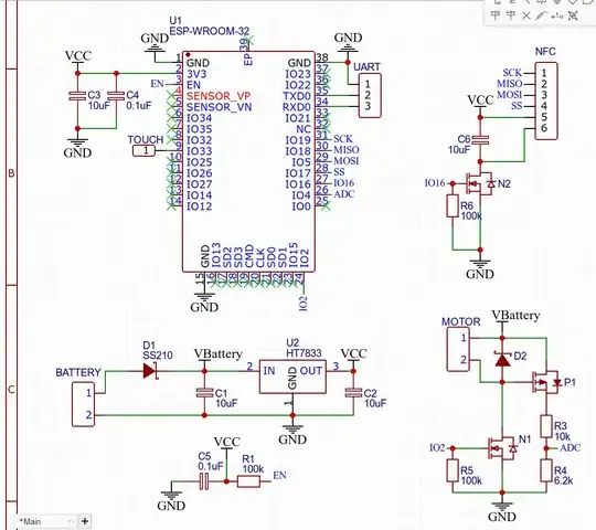

Update: I've reworked the voltage divider/motor circuit. It Now it uses a pmos connected to battery in both drain and gate (Motor is a 6 Ohm resistance so the gate is connected to VB) If my theory works, the traces have so little resistance in relation to the motor (about 0.1 Ohm to 6 Ohm of the motor) the voltage at the gate would be still much lower than the drain (1V vs 8-6V if my calculations are correct, threshold is 1.2V difference) so pmos will be turned on. There's no direct connection between any pin to VB when the circuit is off.

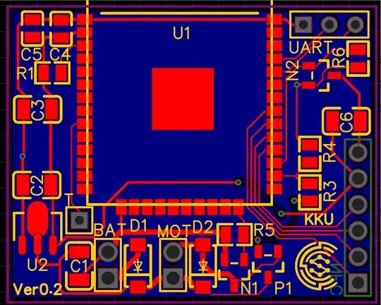

I divided the schematic into smaller parts. Added a diode for reverse voltage protection, reworked the SPI lines to make them adjutant since they were just software SPI. Made battery traces slightly thicker. I've decided to not put any terminations resistors. UART have one internally, while the breakout board have resistance for each line. Of course, ideally you would put the resistors at the sender, but given that they seem to work fine with 20cm of ribbon cables, I think I could skip it? Also used smaller caps for 100nf values. I've bought separate BMD for my Li-ion so I don't have to fiddle with that.
Ver0.2 Schematic: enter image description here

1. Aesthetics:
Please never draw a schematics like this. I wish your second schematics will be nicer one.
The ground should always be in the bottom and the supply should always be on the top. Poor drawing simply sets off readers because it is so difficult to comprehend and needless to say it doesn't look good. You should really follow the tips in the link below. Rules and guidelines for drawing good schematics
The pulldown is very difficult to identify.

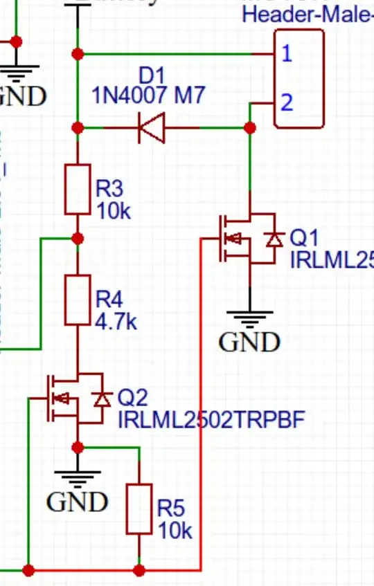

The free wheel diode can be connected directly across the 2 pin connector, it will then speaks it purpose to the reader by itself.

When the Q2 Transistor is off the battery voltage (~7V) will be directly applied to the IO4 pin of ESP. though the current flow is limited it is still the violation as per of the datasheet. Also, plan a clamp diode so that in such a case the voltage will remain clamped to a safe level across the pin. Other option is to use a PMOS switch.

  12. Vbattery trace is dangerously thin. The same track goes to drive the motor.

  14. The battery voltage divider needs your attention. The resistor combination should be in such a way that the voltage developed across the botttom resistor (which is connected to Q2) should be measurable. Always less than ADC Reference voltage for example. Consider use case if fully charged battery which is about 8 V according to you, 5% regulator tolerance, tolerance of resistors too
