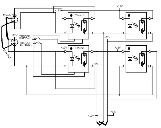

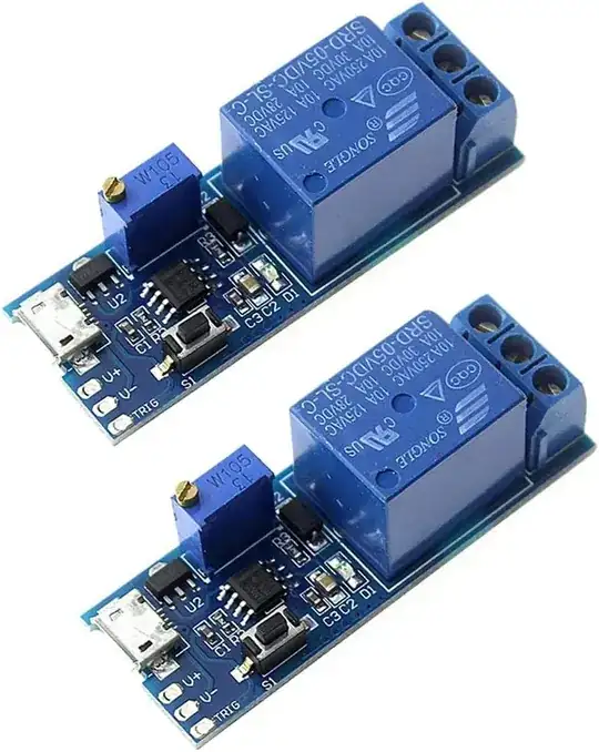

So my idea seemed simple, try to hodgepodge together with parts on hand, a device that when one trigger is pressed, timer relay turns on for 5 seconds, it applies 12v to a set of leads, opening a valve. When the second trigger is pressed, timer relay turns on for 5 seconds, a reverse voltage of -12v is applied to the same leads, closing the valve. I used the timer relay, to trigger a secondary jqc-3ff-s-z relay to open both the positive and negatives to the leads, with the idea that when I apply the opposite polarity to that lead(from the other timer), nothing would short as its NO.
Problem is, when Timer 1 is triggered, it will also sometimes trigger the second timer when it turns off. Either that or it will loop itself 2-4 times turning on/off/on/off.
I am assuming that I am missing a diode somewhere, or im overlooking something thats very clearly right in my face. I attached a crude diagram below (apologies) as well as a picture of the timers. Any ideas to help me get this thing functioning the right way are appreciated. enter image description here

  • It is senseless to use optocouplers this way. All they do here is to bloat BoM and cause potential problems when they break. Also, your schematic is unreadable - check out https://electronics.stackexchange.com/questions/28251/rules-and-guidelines-for-drawing-good-schematics – Lundin Aug 30 '23 at 06:07
  • Your schematic shows four opto-isolated modules, the relay module that you actually show (and the relay P/N you listed), seems to use a basic mechanical relay. Do you need the isolation? In your circuit you actually have the 12V wired to both ends of the opto-isolator, (witch makes it non-isolated). The NE555 delay circuit on the module (you show) drives the relay with a time delay set by the potentiometer. – Nedd Aug 30 '23 at 07:27
  • Could you please upload the valve data sheet or furnish a link to the same? – vu2nan Aug 30 '23 at 14:46

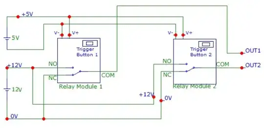

Using your explanation of the requirement, and using the two time delay relay modules that you've shown, the circuit below is how I would wire this.
With the modules connected in this way it would be impossible to short the supplies. Even if you were to press the trigger button on module 2 with module 1 still enabled the circuit would first disconnect the +12V then apply only the -12V to the output.
You could likely also do this with a single 12V supply* if you wanted to add additional switching circuits, however your original schematic already seems to show two 12V supplies being used.
Circuit 1
Circuit 1
Circuit 1 Operation:
Pressing the trigger button on Relay Module 1 connects the +12V on the NO pin to the COM pin.
The +12V then continues to the NC pin of Relay Module 2.
With Relay Module 2 still off the +12 continues from that NC pin to the COM pin then to OUT1.
This connection continues for the delay time as set on module 1.
Pressing the trigger button on Relay Module 2 connects the -12V on the NO pin to the COM pin.
The -12V then continues from the COM pin to OUT1.
This connection continues for the delay time as set on module 2.
If you wanted to use the +12V supply to also power the modules (rather than a separate 5V supply), this would likely work but you should add a good amount of filtering to insure that no voltage spikes get into the module's power pins. You might even add a pre-regulator circuit of 8V or so between the +12 supply and the module's input power. With or without a pre-regulator good size by-pass/filtering caps should be used.
