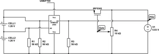

I've red though your recommendations and tried another test
Here goes the updated circuit:
test circuit Batteries - NiCd, 1.2V, 2500Ah
PSU is LM2596S based buck converter (16V/5.4A -> 5V/3A)
Current limiting device is a P-channel MOSFET (IRF5305). With its gate pulled down to ~0.65V it passes exactly 0.25A.
Current measurements were confirmed with two separate ammeters plus with a shunt resistor (5W/1Ohm resistor in place of CElL1 & CEll2).
Voltages were measured with ATMEGA 2560 ADC. Also, each measurement was confirmed with the two separate voltmeters.
CELL1 / CELL2 resistance (disconnected) = 165 Ohm
The results under no load (Voltmeter / Atmega):
  • PSU(V): 5.03 / 5.03
  • A0(V): 1.36 / 1.37
  • A1(V): 2.74 / 2.72
  • A2(V): 5.03 / 5.03
The results under load 0.25A load (Voltmeter / Atmega):
  • PSU(V): 5.01 / ---
  • A0(V): 1.64 / 1.68
  • A1(V): 3.25 / 3.28
  • A2(V): 4.85 / 4.9
The results under load 0.5A load (Voltmeter / Atmega):
  • A0(V): 1.67 / 1.69
  • A1(V): 3.34 / 3.39
  • A2(V): 4.82 / 4.86
The "under load" voltage drop:
  • 0.25A results in 15mV delta (o.06 Ohm)
  • 0.5A results in 19mV delta (0.38 Ohm)
considering the measurement bias, I've come to a conclusion its a breadboard which introduces 0.05 Ohm resistance. I've tried connecting A2 pin directly to PSU's Vcc via 20cm wire and yes, the voltage drop reduced by 12mV (2mV@0.25A and 7mV@0.5A)!
The one weird thing though - why does increasing the charging current also increases the voltage over the battery cells (NiCd)?
