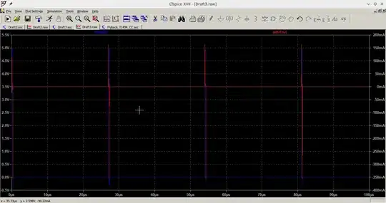

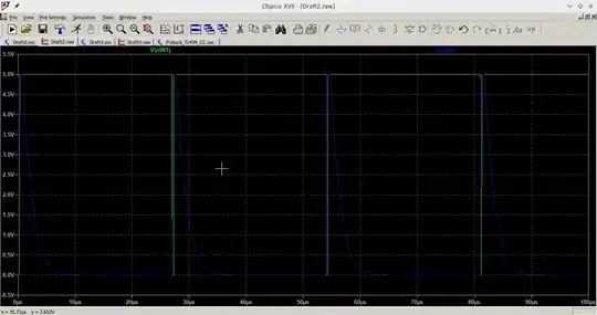

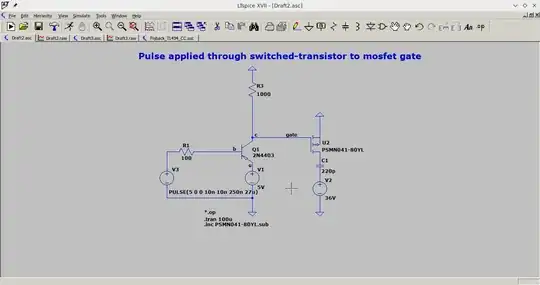

74hct14d can at the maximum supply upto 20mA load which is not adequate for the mosfet gate which needs in the least a few 100mA to switch in nano-secs. I tried using a fast transistor mmbt4403 for supplying increased current to mosfet gate. It is switching, it introduces a long turn-off delay, as it has a high storage time of 225 nano-secs. So, in spice simulation, I could not get better than 1.2 us switching time using 250 ns trigger signal. (This switching time is at the gate of the mosfet - see draft2 circuit and draft2-output).

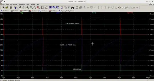

Using a NMOS to switch at 5V logic and PMOS to switch at 36V power, I get result like draft1.png. Even in this case, it must be mentioned that the gate current spice simulation shows a couple of hundred mA, which cannot be supplied by 74hc14d.

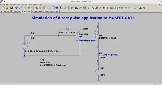

If I directly apply 250ns pulse to the gate (for proof-of-concept - see draft3 circuit and draft3-output) in spice-simulation, I get about 300 ns switching time on mosfet which is manageable.But this cannot be done due to 74hc14d output current limitation.
And I cannot supply enough power to mosfet gate using a 5V logic, so cannot switch it without enhancing gate-current. Enhancing gate current with transistor or signal-mosfet introduces unacceptable delay. What options I have ?

    @Bimpelrekkie, "Also how you use the PNP to pull the gate down is weird."(draft3.asc) This is taken actually from a TI converter implementation and works well. In this circuit, my only issue is that actual signal-generator 74hct221 cannot give the current the simulation power-supply is giving,which is about 400 mA. Draft3 circuit is just proof-of-concept and works if only same current could be sourced from 74hct221d IC. – Ever-a-Student May 07 '21 at 08:20

  • @Bimpelrekkie, "In your first circuit the "push current" is limited by the 1k resistor", I have tried the resistance R3 values from 10 Ohm - 1000 Ohm. Gate is parallel to it,so it should not affect push-current, but it will affect 'pull-current'. But I see no difference in turn-off time from 10 Ohm-1000 Ohm. Gate turn-on is already good, 10 ns. – Ever-a-Student May 07 '21 at 08:34
