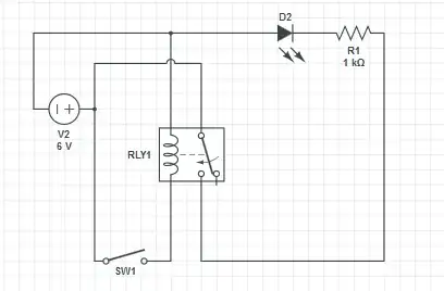

This may seem simple but I am trying to learn EE. In the below circuit, how can I add a delay when the button is released the relay will stay energized for approx. 5 seconds.
My Circuit:
Coil Voltage Nominal 5VDC; Max - 6.5vdc
Input voltage = 6VDC
As I mentioned I am learning. My initial thought was a resistor–capacitor circuit (RC circuit). But I am not sure how to achieve this. Thank you for the help.

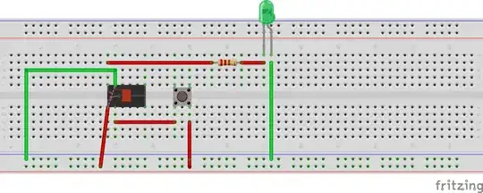

Edit - as suggested I added a schematic. I hope its correct. enter image description here

    What Olin is trying to say is that it is much easier to communicate an EE design by sharing schematics than looking at the board wiring directly. To be well received on the site and to get great answers, questions must include clear and concise schematics. Since you seem to be on your way to learn EE, take a look at those great posts: http://electronics.stackexchange.com/questions/28251/rules-and-guidelines-for-drawing-good-schematics and http://electronics.stackexchange.com/questions/1024/good-tools-for-drawing-schematics. I believe that they will help you a lot. – Ricardo Jun 30 '14 at 12:23
  • @Ricardo Thank you for the help. I will post a schematic shortly.. – PhillyNJ Jun 30 '14 at 15:32
  • @OlinLathrop - I add a schematic as suggested. Sorry for using the Fritzing diagram. I hope the schematic is correct as I am trying to learn. – PhillyNJ Jun 30 '14 at 16:24
  • The relay will be actuated, but the LED is connected backwards. – EM Fields Feb 09 '16 at 12:03
