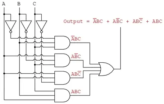

But what I still missing is the ability to read and understand an anolog circuit schematic in the following sense: when I see a digital circuit schematic, it is easy to identify where are the inputs and the outputs, how data flow through the circuit and how each stage transforms the input signal. For instance, the following image is easy to reason in terms of inputs and output.

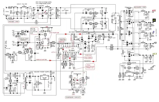

But when reading an analog circuitry schematic, I can't, yet, divide the schematic in blocks/parts by myself even with careful studying. For instance, the following schematic (a SPMS):
Because of so many in series and parallel conections and because current can flow in both ways in some parts of circuits it is hard to me reason in terms of input and output.
So here is my question: is there a way to read and interpret analog circuit schematics in terms of input/output in the same way that is possible to digital schematics (logic gates, for instance)? Or for analog circuitry there is another way of reasoning about the circuit? In other words: is there a systematic way, an algorithmic way, to read and interpret analog schematics or each circuit requires an ad-hoc analysis? Is there an abstraction that electrical engineers use?

  • @OlinLathrop, would you mind give me an example regarding, for instance, the Q1 transistor at the top-middle of the SPMS schematic? It is the Q1 whose base is connected to resistors R6, R7 and R8. There also a diode D3 and a capacitor C9. This is an example of a topology that I haven't see so far in my reading. – Hadley Siqueira Sep 21 '18 at 12:40

  • Q1, and friends (Q2, D1, D2, that mess of resistors and the like) can be recognised as a half bridge topology (Very common in switchers in this sort of power level). D3,4,C9,10 and associated resistors are doing a bit of pulse shaping of the base drive pulses from T2. Once you spot how C7 is connected to T3, you are looking for the half bridge circuit because it will be there somewhere at least 9 times out of 10. The fun thing with this particular supply is the magnetic amplifier used to improve regulation of the auxiliary rails (That 5 winding inductor in the middle of the output section). – Dan Mills Sep 21 '18 at 19:41

For instance, you have illustrated an SMPS. By definition, this takes a power input, and delivers a regulated DC output. You now have to scan the schematic, until you find the words 'INPUT FILTER' at the top left, and 'DC OUTPUT at the top right.
Within that circuit, there will be many blocks which individually have an input and an output, and are strung together to perform the overall function. Here the part identification is your friend, and after googling them a few times, you will get used to the numbers quickly. The TL494 and the 78L05 are a switch mode controller and a low power voltage regulator respectively. You read the data sheets for those, and they tell you what the parts do, and what the pin functions are.
The examples you've chosen for digital versus analogue are somewhat extreme. If you'd posted the schematic of an MCU, with busses going between RAM and ALU and peripherals and ... you get the general idea, no inputs or outputs obvious unless you know what you're looking for. The analogue equivalent in complexity for your ABC logic function would be somewhere between the TL494 and the 78L05. The SMPS equivalent would be the MCU.

The digital "circuit schematic" you provide is one step beyond a circuit schematic. Where's the power supply? What kind of IC do I use? Which gates are in which ICs? What are the pin numbers? What about decoupling capacitors? Connectors? ESD protection?

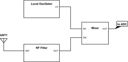

Nothing says schematics at a similar level of abstraction can't exist for analog circuits. For example, here's a very basic software defined radio:
schematic

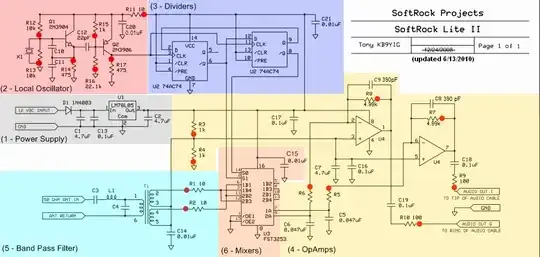

Here's another, a Softrock Lite II:
The only difference is the amount of detail present in the schematic. One distills the circuit into functional blocks with clear inputs and outputs. The other provides a complete description of each physical component in the circuit and how they are connected.
You asked how to interpret schematics in terms of input and output. If it's the kind of schematic that shows functional blocks, it's easy.

  • Thank you for the answer. I completely understand what you said, sir. But, by lucky, you posted an image (the second one) where the colors seems to indicate a clear separation of stages. This gives me the idea that these parts can be designed alone and them combined together. But, for instance, when I see capacitors C2, C15 and C17 I wonder if U3 won't see a combined capacitance value instead of just C15 (which seems to belong together with U3 by the colors). Also, when I see U1 and U4 it seems that there is a natural path for the current because of the high/low impedance of these components – Hadley Siqueira Sep 21 '18 at 14:31

  • Just to reinforce: is it really possible to design the colored parts one by one and then just connect them together by simple wires as it occurs on the second image? – Hadley Siqueira Sep 21 '18 at 14:34
    Yes, if you specify the parameters of each input and output and are sure they are compatible. That's how we break down a complex design into a series of modules or sections. – Transistor Sep 21 '18 at 15:27
  • The line from U1 pin 3 is the +5V power supply, so C2, C15, and C17 are power supply bypass capacitors. You can see that that line delivers power to all circuit blocks. When analyzing the operation of the whole circuit, you can largely ignore that power supply line, as it is not involved in the signal flow or processing. I suppose I can recognize that line as power because I know that the LM7805 is a very commonly-used voltage regulator. – Peter Bennett Sep 21 '18 at 15:40
  • @HadleySiqueira Just like there are well-structured programs that are a delight to read, and there are heaps of spaghetti code that work but are utterly impossible to understand, there is wide variance in the readability and utility of schematics. A good schematic groups related components, has labels to help the reader, minimizes the number of crossing lines, has a general right-to-left or top-to-bottom flow of things, etc. Bad schematics just throw crap on the page. Just like there are a lot of bad programs, there are a lot of bad schematics. – Phil Frost Sep 21 '18 at 15:49
  • To elaborate on the reason that C2, C15, and C17 are treated separately as part of their corresponding blocks, and not analyzed via replacement with an equivalent larger capacitor, is because they are not just 3 capacitors in parallel. They are separated by trace inductance (not shown on schematic), which keeps them separate, and is the reason they exist in the first place (having IC power pins connected to a trace with inductance is a bad idea, you want power pin supply to be capacitive) – Ben Voigt Sep 22 '18 at 02:45
