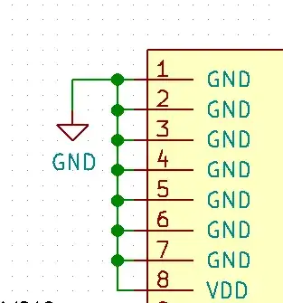

It may be tempting to put pins in the same order as they are on the package. After all, it makes it easier to compare the schematic and the PCB.
But there is a significant danger of mistakes. Especially voltage supply pins are usually spread on all sides of the package, and may not follow any clear order. Then when you are connecting them in schematic, mixing up or forgetting some is much easier than if all VSS pins are next to each other, and all VDD pins are next to each other.
I was chasing a short-circuit under BGA chip for quite some time. Then I realized it was a schematic error with a completely different chip, which had its symbol drawn in the order the pins are on the package:
Accidentally short-circuited VDD in a row of GND pins
