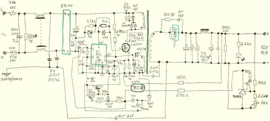

I am an engineering fresh graduate with an interest in PCB design. I have been learning KiCAD which is really fun and I enjoy it alot. A friend came to me with the reference circuit attached here and said he has this smps but needs a smaller design.
Reference Image for the supply

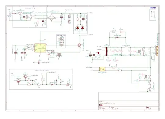

I have made the schematic of it. Its a 100-230VAC to 12V-10ADC power supply. Schematic prepared from the fer circuit I have a few concerns which are:
  1. Even though the schematic is complete, I want an expert opinion on it. Also it feels like its hard to read for someone how doesn't have the reference circuit. How can I improve on the schematic drawing?
  2. Although SMPS's are so so common, I could not find a proper documentation that help one in selecting the components to meet the required current and voltage measurements at the output. If someone can share a source or their precious knowledge, I would really appreciate.
  3. Apart from the component selection, I am curious about the theory behind the working of SMPS. Why high frequency is needed, how the required output is achieved through signal processing and other things.
Lastly is this design ready to start making PCB? Thanks a lot for your help..

    I cringe when someone says "I need this Mains AC SMPS design but smaller". There are often very good reasons why the design isn't as small as it could be. Especially with mains connected circuits certain distances need to be respected. A mains AC SMPS is NOT a good project to start and learn PCB design. Start with something that completely runs on low voltages. – Bimpelrekkie May 16 '19 at 06:26
    "Why high frequency is needed" You need to take several steps back and educate yourself and start with something simpler. Also, working with lethal mains voltage is not a starting project! Your schematic is hard to read due to positive voltages not pointing up and negative down. Same goes for transistors. – winny May 16 '19 at 08:28

There are many unwritten rules and common practices for drawing good circuit diagrams.
My first rule is that it should be clear, an experienced circuit designer should be able to quickly recognize certain common structures.
I think you have the basics covered which are mentioned in this answer. It is good to read this in any case.
Dave from the EEVBlog ran into a "crappy" schematic one day so he decided to make a video to show how that schematic could be improved. Here's the video.
Dave has been a PCB designer for years before he became a full time Youtuber so you can trust him to spot issues in any PCB he encounters.
The design of the circuit itself is a completely different ballpark. Normally in a company the circuit designer designs the circuit while the PCB designer designs the PCB. That is not to say that this cannot be done by one person of course.
It goes too far to explain the design of an SMPS here. To learn how to design circuits you will need to spend time and effort to familiarize yourself with it. Start by analyzing existing circuits, try to figure out how they work and why things are done as they are.
Regarding a mains powered SMPS like in your schematic, that is really a specialist area as it combines high voltage and safety is a concern. So without fully understanding the ins-and-outs of such an SMPS you should not actually make a real design for that. The schematic is mainly functional as in that it shows how the circuit components are connected so we can determine how it works.
What the schematic does not show is how large isolation slots need to be, what distance between the low voltage and high voltage sides need to be observed and what special components are needed.
For example, there's 10 nF, 2 kV capacitor in the original schematic (you missed it in yours!!!). Anyone familiar with SMPS designs will know that that needs to be a Y-class capacitor (read here). If that's not understood and a "normal" 2 kV capacitor is used, the SMPS will be unsafe. When the capacitor fails it might short and give an electrical shock to the user.
So, be safe and start with low voltage circuits and gradually build up your knowledge.
Tell your friend who need a smaller SMPS to just buy one. To really make a proper smaller design the complete design might need to be reconsidered. You can only make a safe and small SMPS when you have the experience to do that.
