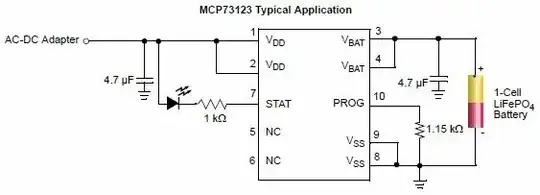

In my past, limited experience with making schematics, I lay out the pins in numerical order, which is typically pin 1 to (N/2) from top to bottom on the left, then pin (N/2+1) to N from bottom to top on the right.
While that's fine and all, I'm now laying out a board for the MCP73123 to test a LiFePO4 charger (because of my other post here) and noticed that in Microchip's datasheet, they lay out their schematic like this:
Personally, I would think this is the way to do it, since CAD/CAE tools know what the correct pin assignments are anyway, and this looks a heck of a lot cleaner in the schematic since related pins are within close proximity of each other.
So my question is simply, do you experienced PCB designers typically do this, or do you go with the numerical-order approach? What do you consider to be the pros / cons of each approach. Also, is there another methodology?

    Yep we do that all the time. Typically you make the schematic symbol so it's easier to read, and easier to wire up. Which is what they've done in your example. Like you said when it gets to layout the pins will be where you want them. Just be careful that your footprint has the pins in the right place. It's easy and common to mess up the pin arrangement on say a sot23 (3 pin device). If there's ever going to be a doubt I usually draw a sketch of the foot print pin numbering on my schematic. – Some Hardware Guy Oct 02 '12 at 13:49
  • When you first make or import the schematic symbol, the pins may or may not be in order, but CAD systems have a function that allows you to move the connections around the symbol while keeping them associated with the correct pin number. – Jeanne Pindar Oct 02 '12 at 14:49
  • Often, some of the bookkeeping-type pins, like power and ground, are even put into a separate gate that assumes input from certain standard nets and made invisible! I always like to verify they're connected the way I like by using the invoke command to call them up. – Scott Seidman Oct 03 '12 at 22:38

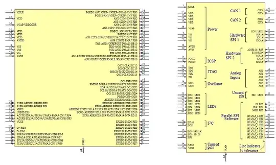

You should do whatever you need to do to satisfy those requirements. Personally, I have laid out chips every kind of way depending on my needs for that particular circuit.
I have laid out the pins for microcontrollers in pin order, matching the real device. (And FakeName now probably thinks that's how I always lay out my symbols). I sometimes arrange create a different schematic symbol for a device for every application, because that's what makes my job easier in those cases. I sometimes arrange small devices in pin order, sometimes in function order.
If you're going to lay out a microcontroller in function order, when what function order?
PIC32 symbols
This is the same PIC32 drawn different ways. The first in some generic function order, the second in an order for a specific circuit. As you can see, the left hand symbol is about as useless as a pin order symbol. So if you choose the function order route, be prepared to draw a different symbol for each circuit.

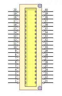

I almost always draw connectors to match the arrangement of connections on the actual connector. This really helps stop me wiring up the connector backwards (which I seem to do a lot). I even try to draw in details of the connector, so that when I'm debugging, I can easily correlate the connector on the board with the symbol.

Whatever you do, do it because you find it helpful. Do it whatever way helps prevent you making mistakes. And whatever way helps you to debug the board. Don't listen to anyone else tell you there's only one way to do it. Don't be ashamed to do it your way.
Whatever way you choose, it may never fully satisfy you. I find that some parts are best drawn in function order for the design of the circuit, but when it comes to debugging, I wish I had another version of the symbol in pin order, and I end up opening up the datasheet, searching for the pin information, and reading through the large number of functions for that pin, trying to remember which one I used. Or I have to look right around the symbol several times trying to find pin 139.
