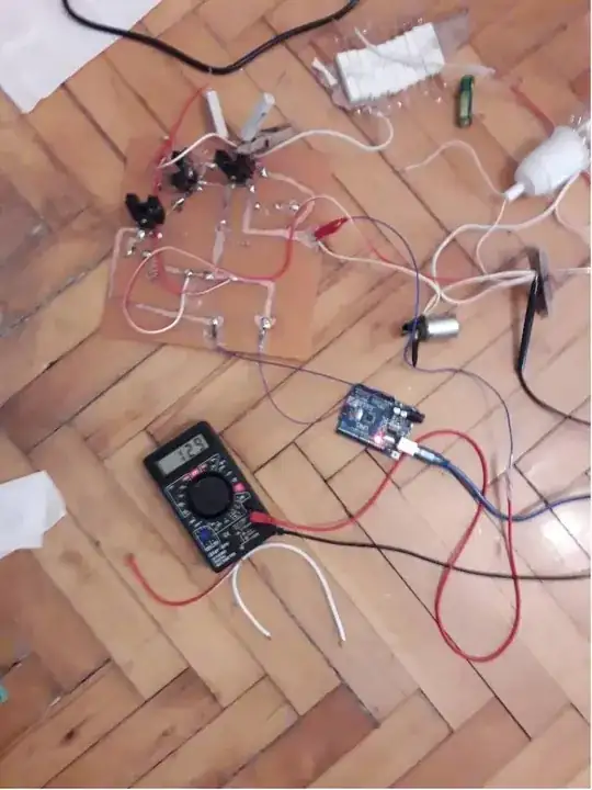

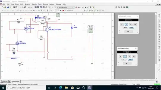

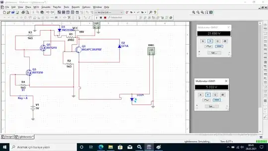

Why doesn't my IGBT module work? I shared my Multisim file as a download google drive file. Can you solve the IGBT problem? IGBT strangely doesn't work.
The emitter voltage is only 12V. I expected it to be equal to Vcc - about 98V.

  • First and second same picture but First Have 35 volt second is 100 volt results for showing to you – Murat Özen Mar 27 '21 at 15:35

  • There was nobody who knew the subject and I solved the problem myself by doing trials while waiting for an answer. But then the voltage did not rise above 12 volts at all. I updated the experiment results. The subject is the same. I'm trying to drive igbt. How can I simplify the scheme. Driving iGBT with a p channel mosfet. It does this by connecting iGBT's positive pole to igbt's gate leg. The other irfp250 n-channel MOSFET turns on and off the p-channel MOSFET by means of the signals it receives from the Arduino. – Murat Özen Mar 28 '21 at 09:12
  • Okay I added Multisim File Download Link For Circuit Please Run and See this igbt is so strange. Even though I'm running full power, it can still send 12.4 volts at most. – Murat Özen Mar 28 '21 at 09:18

  • OK . But really the situation is confusing. When I deactivate the trigger mosfet and manually power the gate leg, igbt only sends 12.4 volts of electricity. I saw it in real test . – Murat Özen Mar 28 '21 at 11:25

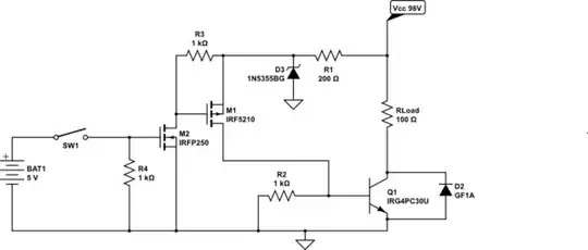

Since you seem to have fixed the "burning" problem and now only have a "low output voltage" problem, I think I can help.
Your IGBT is being used in a way similar an emitter follower would be used with regular NPN bipolar junction transistor (BJT.)
With an NPN BJT emitter follower, the emitter will always be about 0.7 volts lower than the base voltage - regardless of the collector voltage.
It is similar with your IGBT. The emitter will always be a few volts below the gate. According to the IRG4PC30U datasheet, \$V_{GE}\$ is something between 3 and 6 volts.
You have D3 (1N5333B datasheet) there, clamping the gate to no more than 18V. That matches just your emitter voltage of 12V. 18 on the gate minus 6V \$V_{GE}\$ is 12V.
You are trying to use your IGBT as a high side switch. It would work better as a low side switch.
I've redrawn your circuit to be easier to read, and also so that I can modify it into a low side switch. The schematic editor on the site here doesn't have an IGBT symbol, so I used an NPN transistor but gave it the correct part number.
schematic
With it drawn that way, it is clearly a high side switch. The voltage to the load can never be more than the voltage on the gate of the IGBT.

  • How do I boost the voltage it sends? I will run a 3 phase motor. I can run 3 negative pole phases with irfp250. I need 3 positive pole phases. If I run it with 12 volts, 3 negative phases and 3 positive phases turn the motor. It can do this with the Arduino uno control signal. But it should be able to send me exactly 100 volts and one ampere of positive electricity. Because I can only stop the three phaze motor with my finger. It is running only 12 volt. Not 0.7 volts I give 98 volts of electricity igbt only sends 12.4 volts. How can I fix this by making a change in the circuit? – Murat Özen Mar 28 '21 at 11:47

    It can't operate a simple light bulb because you are incorrectly driving a high side switch. You have to have a high voltage on the gate to get a high voltage on the emitter. Your circuit can't do that. It can easily be a low side switch, but that apparently isn't sufficient. – JRE Mar 28 '21 at 12:46
  • Thank God I was finally able to find an answer. This is very good. So what circuit can do this? Is there a ready-made electronic scheme that you know will be able to do this for igbt module? As an example, google electronic circuit diagrams? – Murat Özen Mar 28 '21 at 13:03
    Take your pick. Use a proper driver. Look for "IGBT high side driver." – JRE Mar 28 '21 at 13:09
