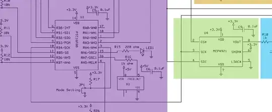

I was told C6 is a bypass for the oscillator(X1). Now I have been building this circuit and I understand that in Eagle grounds are connected automatically and so are voltage sources without having to draw a net between them, which is nice. But why is C6 etc just floating shouldn't it be connected with the oscillator in one way or another? Let me know if clarification is needed. Thanks!
Wesley Lee
  • 7,914
  • 37
  • 55
    The left node of C6 isn't floating, it connects to +5V as indicated. This triangle with "+5V" or "+3.3V" (see R17) are also global nets just like the ground symbol. This is a very common way to show a supply connection without having to draw the supply line everywhere. To draw a floating pin the small triangle should not be there, example: pin 1 of X1. – Bimpelrekkie Jan 12 '18 at 06:50
    draw it attached to pins 4 and 8 of X1 and you will quickly see how cluttered the schematic becomes – jsotola Jan 12 '18 at 07:44
  • See point 10 of https://electronics.stackexchange.com/a/28255/4512. – Olin Lathrop Jan 12 '18 at 12:26

Bypass or "de-coupling" capacitors which is their other name, do connect between a power rail and ground. As such, as you have already figured out, all those pins are electrically connected together.
That brings up an interesting situation when it comes to drawing them on the schematic.
You would think that the best way would be to draw them attached to the pin of the device you want them to be connected to so it is obvious what the capacitor is associated with.
That IS one approach, however many component symbols have hidden power and ground pins, as such, showing them attached to a particular IC is not always possible. It also makes for a very cluttered schematic. You can, if you wish, place them at the side instead, as you have shown, which visually implies that cap is associated with the thing it is nearest to.

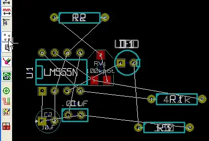

However, even if you do a really good job of that, the PCB designer may or may not follow the schematic when placing the parts. The schematic after all is only a visual representation of the component and nets list.
In reality, the schematic design contains no actual positional information. The data passed to the PCB tool is merely a component list and a nets list. In the latter there will be a line like this..
3.3V, U1-14, U4-1, U4-6, X1-8, C5-1, C9-1, C6-1, R10-1, R12-1, R13-1,...
That defines what the net 3.3V is connected to. Note it does not say explicitly C5 is connected to U1-14, even if you drew it that way, just that all those pins are connected to 3.3V.
Most PCB layout tools, and designers, use what is called "rubber-banding" on a "rats-nest" layout to place components in locations that minimize the trace length and avoid too many crossovers and twisting.
Normally, the schematic designer only details the size of the board and where important things must be, like connectors, switches, LEDs etc. The PCB designer is trusted to place the rest, all be it with some review and approval by the schematic designer.
Unfortunately, since all those caps are attached to rails, depending on the software, they do not rubber-band well or, if you have power and ground planes, may not rubber-band at all.
If you draw your schematic with connections to the devices and the PCB designer is not informed about that and does not follow your schematic manually, the caps can end up in entirely different locations because the PCB designer knows to place them close to chip power pins all on their own.
That does not mean the PCB will have bad decoupling, but rather the C numbers on the schematic will no longer look like what is happening on the board. C5 may be in the position of C9 etc. As such, it is important to chat with the designer on this matter to ensure you both understand what is going to happen.

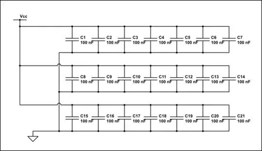

In some cases, if you trust the PCB designer to do his job, you can allow them to add or place all the capacitors on his own and use a "de-couplers" page in the schematic where all the caps are shown en-mass just for reference. A good PCB designer can even be trusted to add and maintain that page for you.
schematic
Personally, I prefer the last method by far. It makes for much cleaner schematics and saves the PCB designer a lot of time not having to thumb through pages of schematics to identify hidden de-couplers before placing each one.

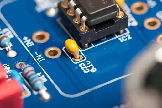

These are bypass capacitors, and should be connected between the VCC and ground of the IC they are bypassing for, as physically close as possible to the IC. So in short, "yes".
As for the schematic, while they are not physically shown as connected to the IC or X1 oscillator, they are electronically connected via the same node (5V and Gnd). They should be physically connected and physically located closely, as determined by the distance in the copper traces. Example:

On the schematic it does not really matter where the bypass capacitors are drawn as long as they connect to the proper power and ground nets. Like you say they are automatically connected. In this case the C6 capacitor is (schematically) connected to the X1 oscillator pins because both components use the same net names, (power & ground symbols).
However when doing the PCB design you will need to physically place the capacitor close to the designated component pins, (in this case C6 should be placed very close to the power pins of the X1).
