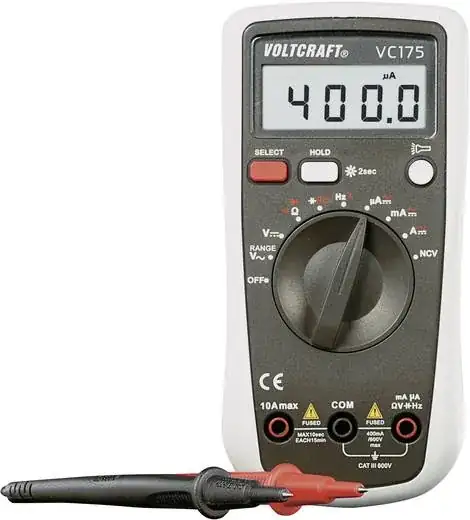

I am a noob in eletronics, so I need some help. I want to debug an i2c sensor with a digital multimeter such like this:enter image description here

My question: how can I use this multimeter with what configuration (position of the pointer and cable plugin ports) on the above setting to debug it? Where put the pins on the setting? Where can I measure something with this multimeter and what values should I expect?

How you connect your measuring device depends on what you want to verify.
With a multimeter you can check pullup functionality and SCL frequency.
For pull up functionality you need to set your multimeter to DC voltage sensing, connect the black probe to gnd, and the red to SCL and SDA, alternatively. Both should read VDD, in your case 3 V.
To measure SCL frequency set your multimeter to Hz, connect the negative probe to GND and the positive to SCL. Now load and run a script that continuosly tries to access the temperature sensor: the frequency you will read on the multimeter is (to some extent) close to SCL frequency.
There are not other tests you can perform with a multimeter, if we exclude basic connectivity checks.
