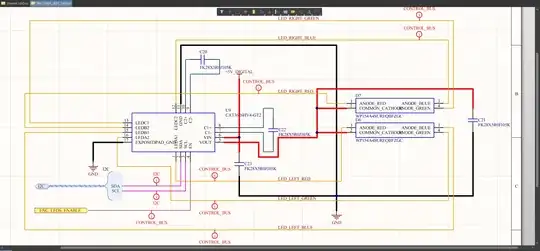

I am trying to create a schematic for driving two WP154A4SUREQBFZGC RGB LED diodes using ON Semiconductor's CAT3626 and here is my schematic:

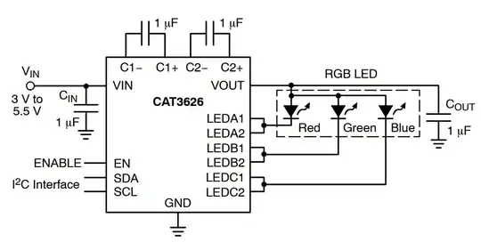

and here is proposed circuit from CAT3626's datasheet:
Kingbright's RGB LED Altium's part library was downloaded from SamacSys webpage. Now, I am confused since I've connected anodes to PWM outputs of CAT3626 because I want to control every color of each diode indepedently, but in datasheet there is a connection as we can see from 2nd image Common Anode Configuration. How do I transform my schematic so it will comply with CAT3626 "rules"?

Use the common anode WP154A4SEJ3VBDZGW/CA
You selected the common cathode.
Misunderstood
- 7,387
- 1
- 12
- 24
So, I selected wrong RGB LED itself, am I right? And I need to upgrade schematics with voltage divider for red channel, becuase it needs 2.2 (max 2.8) V? – KernelPanic Sep 10 '18 at 06:20
1Yes, you selected the wrong LED. You should not need to treat the red any differently. Each output channel (A,B, and C) the current is programed individually. It's a current regulator so as long as Vout is sufficient (greater than max Vf) for all three channels the forward voltage does not matter. – Misunderstood Sep 10 '18 at 12:41
