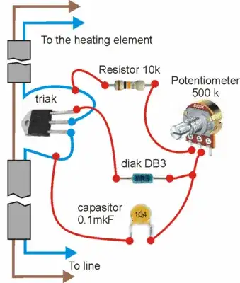

I'm trying to build a micro-controller controlled PID. So far I have found a few recipes for high powered AC voltage ( 10 - 15 Amps ). The first recipe I found involved Using A potentiometer, a capacitor, a resistor a triac an a diac as illustrated below, however this is an analogue controlled system.

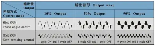

If you are using heater, then a better solution is to use PWM technique with zero cross SSR / triac, rather than dimming with phase control. The entire process won't "see" the difference if you choose for example a 10s PWM period and turn the opto triac with zero cross with a timer controlled output. The phase control also produces EMI and has nonlinear output vs. control phase angle, additionaly you need a zero cross detector. It makes sense to use phase control for dimming lights or for motor control.
EDIT: Difference between phase angle control and PWM control of a triac/SSR enter image description here

The circuit you have shown is for a simple dimmer switch. It is not suitable for your application.

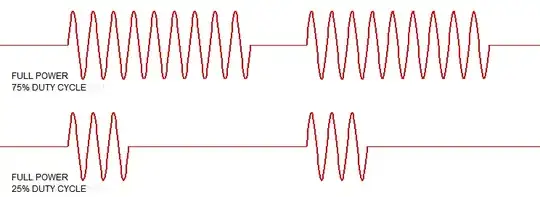

The simplest and safest solution is to use an opto-isolated solid state relay (SSR). A 1500 W heater is likely to have a thermal response measured in many seconds so we can use a simple on-off control system with variable duty-cycle to control the average power being sent to the heater. By making the switching cycle short (say 2 to 5 s) relative to the response time of the heater (tens of seconds) tight control of the temperature is possible.
Figure 1. Adjusting heater power by varying the duty cycle of a mains on-off controller. The waveform is the 50 or 60 Hz mains voltage applied to the heater.
So using the scheme of Figure 1 we can adjust the power from zero to 100% in steps of one mains half-cycle.

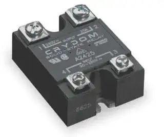

Figure 2. A typical industrial grade SSR by Crydom. These are available in zero-cross and non-zero-cross versions. (This one has an AC control input. For a micro-controlled application a DC input type would be used.
For your application you want a zero-cross type which will, when triggered, wait until the next zero-cross of the mains before turning the TRIAC output on. This will minimise electromagnetic interference with nearby devices.
