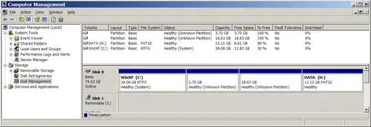

I originally posted a question about removing Ubuntu and GRUB from a dual boot system. This is what my partition map looked like at the start:
partition map

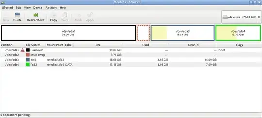

I was able to boot the computer using my PMAGIC recovery disc, and run Partition Editor. This is what I saw:
Mysteriously, a few reboots later, GRUB vanished. Now I just get the message "Invalid Partition Table". If I boot from my Windows XP installation CD, it no longer sees the installed OS, nor an NTFS partition
