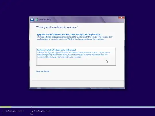

    Custom
  • You'll want to choose Custom:Install Windows Only (Advanced). This option will allow you to erase the current (Ubuntu) partitions that are on your hard drive.

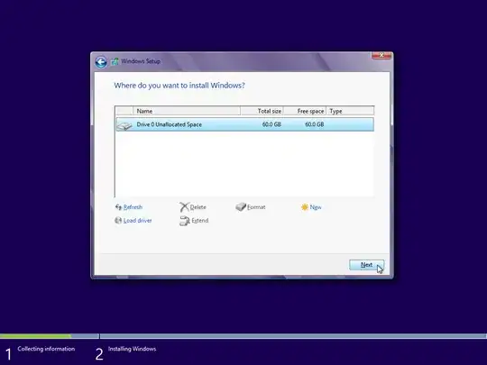

  • Delete all the partitions that are in the list. (Note: This will entirely get rid of Ubuntu as you requested. This includes any pictures, music, documents etc that you had in Ubuntu.)
  • If you deleted them correctly you will see one partition labelled as Unallocated Space
Unallocated Space
  • Select this partition and click Next to continue with the standard Windows 8 install.
