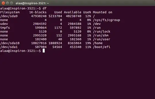

I saw that many people asked this before. For example: How to find out which partition is Ubuntu installed on?. I followed the instructions there and here's a screenshot of the terminal after typing the suggested command (df):
df output in gnome terminal
But this doesn't tell me anything...

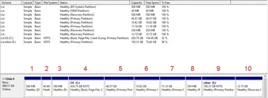

Here's a screenshot of Disk Management in Windows:
list of partitions

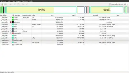

Here's a GParted screenshot:
many partitions
So can anybody tell me which the Ubuntu partitions are? (I numbered them from left to right, so to make it easy just tell me numbers please)

From the output of df command what I can see is the size of your Ubuntu partition is 47930248 KB which is equal to 46 GB approximately.
From this you can conclude that it is your 5th partition(partition which you have marked 5) on which Ubuntu is installed.

Do not remove /dev/sda1 (The 1st partition) The EFI partition is part of UEFI and is used by both Windows and Ubuntu. If you delete it, the computer won't boot.
Comparing the Gparted and Disk Management screenshots, you want to delete 5th, 6th, and 7th partition as displayed in Windows Disk Management. Or /dev/sda9, /dev/sda10, /dev/sda11 as displayed in gparted.

According to your GParted screenshot and what you have told us, you can see that the Ubuntu installation root is installed on /dev/sda9. You can tell this by looking in the "mount point" column and seeing the "/", which is the root. You can also tell that your /home is on /dev/sda10 by looking in the same column.
Both of which are the only ext4 (not that you cannot install using NTFS), but they are the only ones to match up with your mount points.
Also, the rest of the partitions are either NTFS (which is what Windows uses) and are matched with Microsoft flags, therefore you know they are not the Ubuntu install, or they are unknown.
The answer is your Ubuntu installation is using /dev/sda9 for the root, /dev/sda10 for home, and /dev/sda11 is used for swap.

From what you posted, your root partition for Ubuntu is /dev/sda9
sda = first hard drive
sda9 = 9th partition
