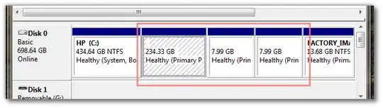

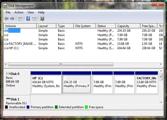

I am trying to uninstall Ubuntu by following these directions, but I have a question. Which partitions do I delete? I am assuming it is the three blank ones, but why would Ubuntu have three partitions? So I just wanted to make sure.

Unless you have installed a third operating system, these are your Ubuntu partitions:
Right-click to remove these partitions one-by-one, and then right-click the first (C:) to extend it across the unallocated space OR create a new partition in there.
Use Windows' diskpart tool to get more info without booting a LiveCD
You can get some more information on the two 8 GB partitions from within Windows by using the diskpart command:

You can boot into the Ubuntu system to see the contents of those partitions more clearly, to make sure they really belong to the Ubuntu system.
The 234.33 GB partition is likely your Ubuntu system's / partition that stores all the files therein.
One of the 7.99 GB partitions is likely your Ubuntu system's swap partition, used to swap pages of memory from RAM to disk to improve performance (and also used to facilitate hibernation).
What's unclear is what the other 7.99 GB partition is for. Unless a second swap partition was created (to increase the amount of available swap), there's no particular reason to have two partitions of this exact size.
Some Ubuntu systems have a separate /home partition, but it's likely you would remember configuring this (just as you'd probably remember reconfiguring your swap), and 8 gigabytes is rather small for a /home partition. (It's big enough, most of the time, but 8 gigabytes is also big enough for the / partition, yet that appears to be over 200 GB.)
So while you're probably safe deleting these partitions, it would be better for you to check just to be sure.

Since this is a Windows partitioning tool, it doesn't really show enough information to be sure. (Linux partition editors know about many more types of partitions.) But I'd guess that the ones with a blank file system type are unknown to Windows and thus Linux partitions. So you could delete them. But I'd boot from the install CD and run GParted first, just to be sure.
