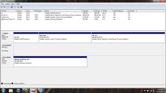

I wish to remove Ubuntu and I'm not quite sure how. I know it has something to do with partitions. I have 3 partitions. 1. OS [683 GB] 2. Recovery [14 GB] 3. Ubuntu 12.04 LTS (E:)
I know it says Ubuntu but when I installed Ubuntu I think I put 14 gigabytes for it so I think its the recovery one but I'm not sure. I could have sworn I put more than 700 megabytes for it.
I have googled this and I can't seem to find an answer. Any help would be nice.

I don't see any ext2 ext 3 or ext4 filesystems which would be a regular Ubuntu install, this leads me to wonder-did you install Ubuntu using Wubi???
If so you can just remove it with your Windows add and Remove Programs window, It should be listed as "Ubuntu" as far as Windows is concerned it's just another program and can be removed
Also as the comment to your question said and I also belive, the 12.04LTS that is showing is an Ubuntu install CD.

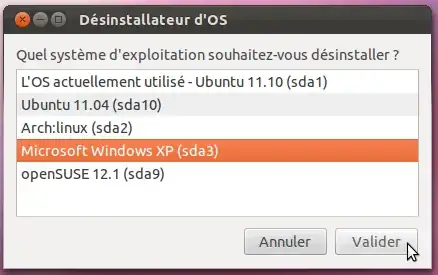

I have your answer.
  1. Boot to a live CD with Ubuntu
  2. Go to a live session
  3. Download and install os-uninstaller with the 3 DEBs on the website.
  4. Start the software and select what operating system you want to uninstall. os-uninstaller-fr
  5. Then click on "Validate" and the soft will do the rest.
  6. When all is over, reboot your computer, and that's it, only windows is on your computer!

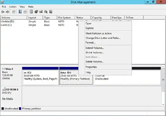

  1. Boot into Windows partition, and use the free, non-commercial version of EasyBCD to reinstall the Windows bootloader.
  2. Reboot and check that you're not using grub anymore.
  3. Delete the Ubuntu partition and extend the Windows partition using the Windows Disk Management tool. Right-click the volume next to the empty space, and select Extend Volume to increase the size of the partition.
    Disk Management
