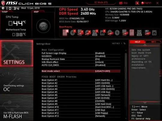

Picture of the BIOS
Windows boots fine in UEFI mode. There is no way to boot Ubuntu in UEFI mode only (as opposed to LEGACY + UEFI mode).

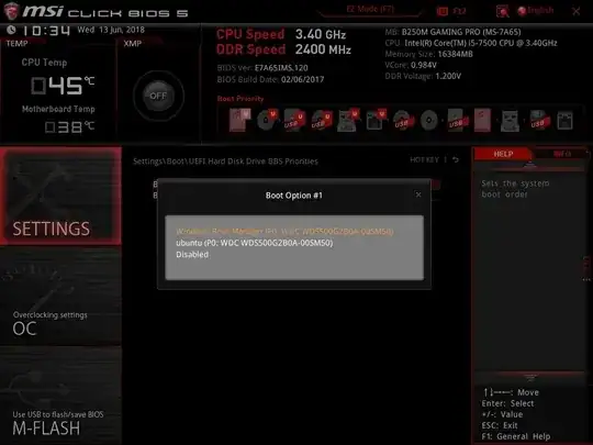

Boot options
Windows also boots fine in LEGACY + UEFI mode when it is set as Boot Option #1.
Ubuntu boot option
Ubuntu fails to boot as expected since I deleted the partition it was on.
