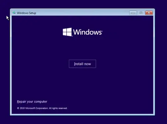

Now it will take you to this screen (you may have to specify what language you want the installer in and some other preferences): Windows installation screen
Click on Repair your computer and it will take you to a menu with some options. Click on Troubleshoot. Then go to Advanced Options. Go to Command Prompt.
