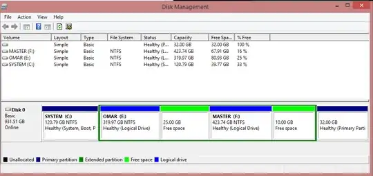

i am trying Ubuntu as my first linux time. Now as the steps of installation i had to shrink my HDD partitions, but in every single tutorial i find it written as unallocated space in my case it's written as free space (every single partition has it own space they are not all mixed up), now my questions.
  • Is it Right to Install That way ? (the space is free not unallocated)
  • Should I Create a New Partition for the Swap or it will just create it itself ? (and if i should i have 4GB RAM what is the needed size for this partition)
  • in case i didn't like the OS can i uninstall using EasyBCD on windows 8.1 ?
  • in the following picture there is a 32GB Partition. What is that ?
The space is shown as free and not unallocated because it's in an extended partition. That's fine, Ubuntu can install to free space in an extended partition.
Can't say. Could be some recovery partition created by the OEM.
