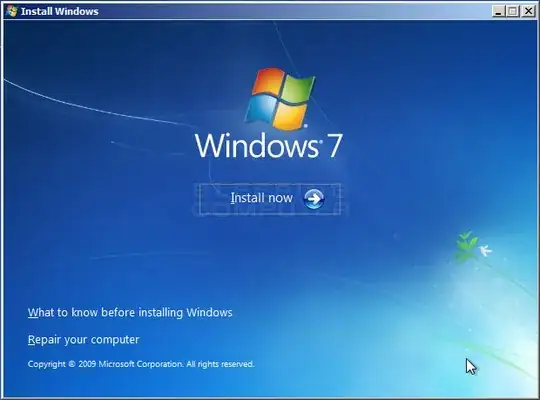

Boot up a windows7 installation CD or USB

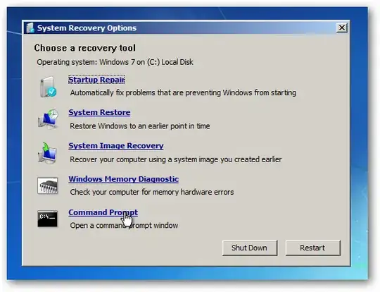

Select Repair your computer then select command prompt

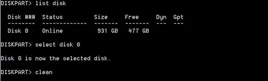

Run
Now you can make partition and install windows
Note: know! this method delete any data on your hard drive
