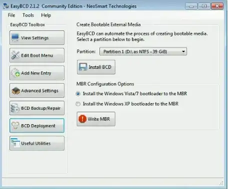

Boot into windows. Remove the ubuntu bootloader from inside windows by reinstalling bcd - easybcd or visualbcd is a good easy way - I'm more used to easybcd
Install easybcd (the community edition is free for personal use)
Select BCD Deployment, select your partition, and clicking on Install BCD and Write MBR. Its dead simple.
Reboot and make sure bcd loads, rather than grub. Delete the ubuntu partition with disk management and resize as you'd like it.
