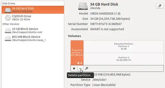

Start by booting from the Ubuntu LiveCD, select to Try Ubuntu and once on the desktop look for the disk utility from the dash, for that have a look on the following post:
Once the application is open delete all the partitions on your hard disk and apply the changes.
Ubuntu will be completely removed from your system by now. You can even try to boot the Windows install without changing the boot order in your BIOS, if your computer cannot find any boot partitions it will try to probably boot from the CD drive.
