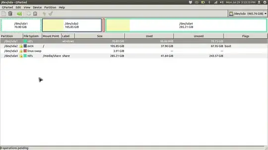

You will then be prompted for a password that should be the same as the password you entered when creating the live media. If successful a screen similar to this one should pop up.
gparted

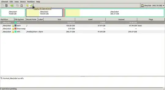

Once the application has loaded and gparted has scanned your drive, Go to the upper right corner of the screen and select the device you wish to work on (the drive with ubuntu on it), click on the partition you wish to format which should be /dev/sda1 if the ubuntu partition is the only thing on your hard drive.
After selecting the partition you wish to format, go up to the menu-bar and select "Partition" then "Format to". This will display a list of different formats. What format you end up choosing will depend on what you plan to install after you remove ubuntu. If you are planning on installing windows, you will need to format it to NTFS. Another linux distro will probably require ext3 or ext4 along with some other partitions like a swap partition.
Format to
After you have selected the proper format, gparted will add the formatting process to pending operations. Once you are ready, click the green check mark that has the label "apply all operations". Gparted will format your partition and your done (kinda).
