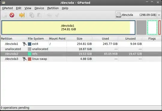

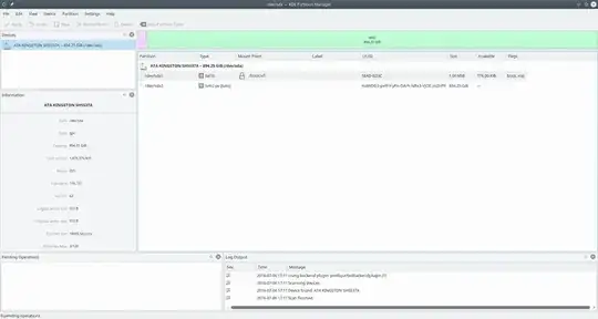

  2. Start from the CD/DVD. If it is an Ubuntu DVD, click the Ubuntu icon in the topleft corner and search for GParted. Then click GParted. If it is a Kubuntu DVD, click the blue icon in the downleft corner, click Applications, and search for Partition. Then click the partition manager. You will see something like this in Ubuntu: enter image description here And something like this in Kubuntu: enter image description here At the top, you can see your partitions. Select the biggest partition.
  3. Click Partition > Resize/Move
  4. At "New size", lower the number with the amount of MB's you want to reserve for Windows.
  5. Click Resize/Move, click the green checkmark, click Apply. Wait. Click OK.
