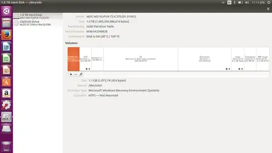

I am trying to uninstall Ubuntu 16.04 and re-install it using VirtualBox. I had installed (dual boot) it using an USB stick. Now I have a problem in locating the partition to be deleted.
This pic shows the disk management page from Windows side.
This pic shows the disk management from Ubuntu side.
from ubuntu side, I got to know that partition 7 and 8 are of Ubuntu while others are of Windows. So, should I delete that on Ubuntu? If I delete that will it effect my windows. If I have to delete on windows, which partition on disk manager on pic 1 should I delete?
Looks like it is partition 7, as it's just before swap partition (classical Ubuntu installation), and seems to be the only one in ext4 type. To be sure, open a terminal, as 'root' and type : - fdisk -l : to get all partition tables - mount : to see where your Ubuntu master partition (called "/") is mounted.

The partition in which your ubuntu os is installed is 7. The file format of the partition is EXT4 which is for linux.
