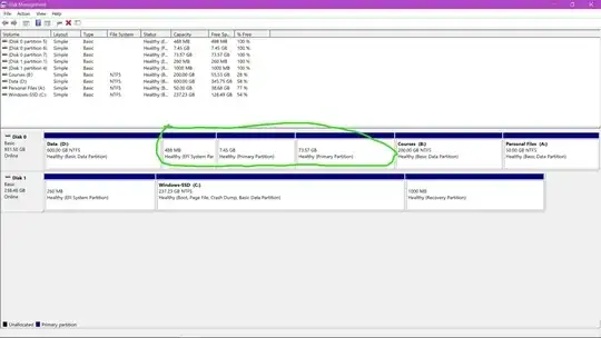

I have installed ubuntu by Manual partition (something else option) and allocated around 80GB for Ubuntu, from it I have also created new efi system partition for ubuntu and 8 GB of swap area(As you can see in the image). Disk manager of my laptop

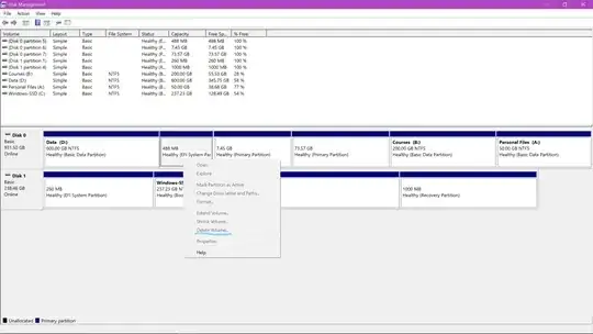

In order to remove Ubuntu from my lap I have changed priority of boot first, after that I booted in to Windows. I have tried to delete spaces allocated for ubuntu, but delete option is not available for newly created EFI system partition. What can I do for deleting EFI system partition(which is created for ubuntu) in Disk 0. enter image description here Please help me to solve this issue.

Delete all partitions except EFI system partition normally using delete option. For deleting EFI system partition refer this video - https://youtu.be/NLOpLizFm3M
