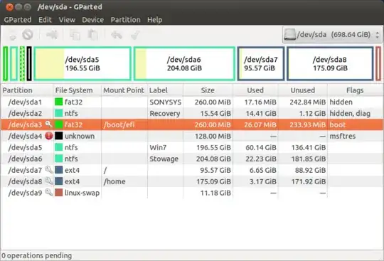

Use GParted to find the relevant partitions - the ones with the /boot, / and /home mount points may be the ones you want to remove. Here is a complicated example I borrowed: enter image description here
Note down things like size, position etc, so it is easier to identify when in Windows Disk Manager, remembering that is a very different view on things.
